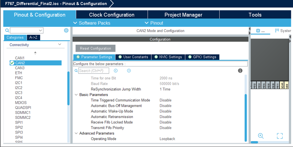

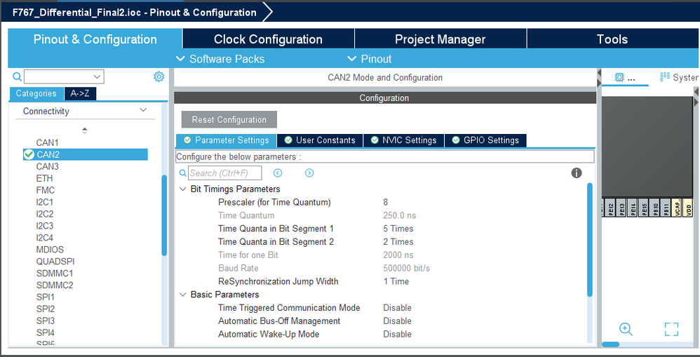

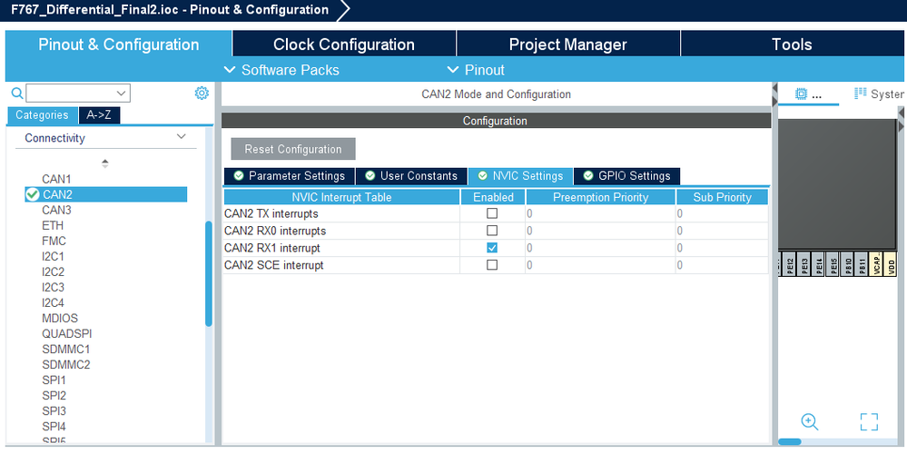

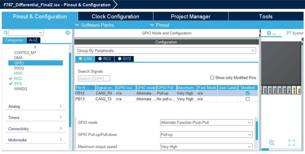

Here are some pictures of IOC file configuration for CAN:

Please attach your project including your ioc file.
