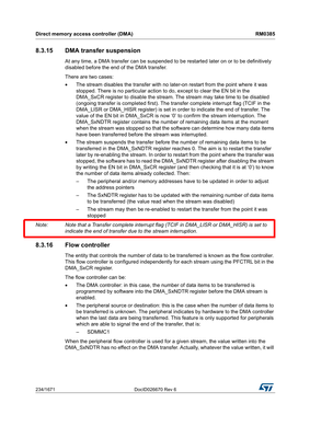

I think I have figured out what happened. Apparently, disabling DMA sets the TCIF flag and fires the interrupt. I did not know about it. Now, the problem is that in my project, I need to disable DMA to change the buffer pointer and data size and this process needs to be done fast (2us), so, there is not enough time to stop and start DMA again. And for some unknown reason, if DMA is in normal mode, it doesn't fire the interrupt after the first time even if the TCIE bit is set.

I do not believe that disabling DMA sets TCIF.

I have been disabling the DMA after calling HAL method. This is what has been setting the interrupt. This I just tested. So, it is not a bug, I just didn't know this information. Found it from the below discussion-
https://community.st.com/t5/stm32-mcus-products/restarting-dma-with-new-configuration/td-p/455057
Another interesting thing I found is that if DMA is disabled while within interrupt routine, it doesn't fire any additional interrupt, probably because the TCIF flag is already set.
