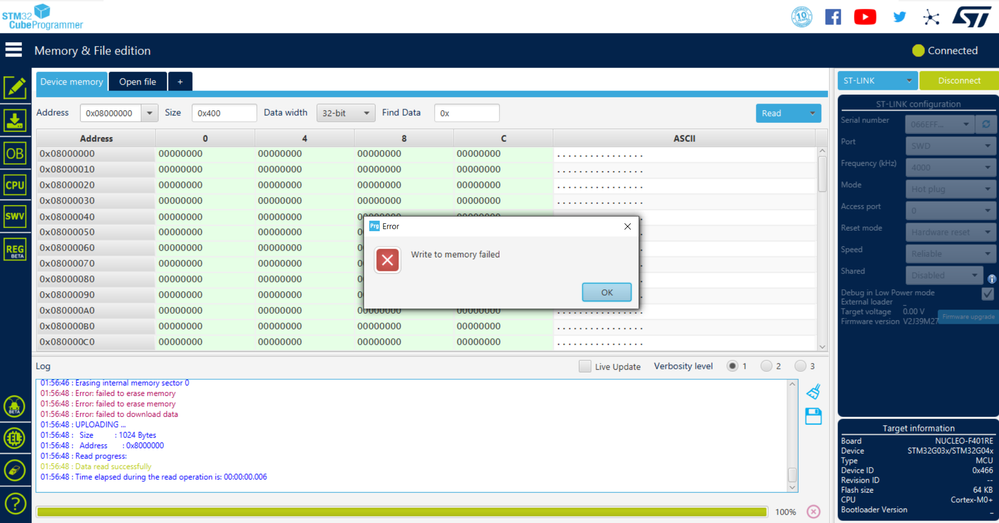

Hello, I am not able to program STM32G031. I have Nucleo kit F401RE and STM32G031 connected to SWD. I have connected SWDIO, SWCLK, 3V3, GND and nRST.
STM32CubeProgrammer can connect only in Hot Plug mode, but writting or errasing gives me: Error: Mass erase operation failed.Please verify flash protection
If I try to connect in Normal mode or Under reset mode, the error is: Error: ST-LINK error (DEV_TARGET_HELD_UNDER_RESET).
Can you help me how to continue? STM32G031 is completely new, never programmed before.

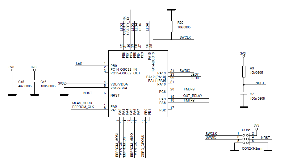

‎2024-07-27 7:10 PM - edited ‎2024-07-27 7:10 PM
Suggests NRST is being held low. Can you verify with a multimeter?
Likely to be an issue with the board design or assembly, or the wiring between the programmer and the board. Can you share the schematic?
‎2024-07-28 8:40 AM
All voltages are OK.
This is the schematics:
‎2024-07-28 8:51 AM
Sure , that your target is powered ?
st-link seems to get no voltage:
try connect with mode : normal + software reset .
‎2024-07-28 9:20 AM
Yes, it is, I tried different kit for programming. Setup is according your recommendation
‎2024-07-28 9:54 AM - edited ‎2024-07-28 9:55 AM
But its connected here:
So look at option bytes, if something set, write protect or so.
Be careful not to do anything with rdp level - read first, what this doing. (you need a new chip then...)
Then try full chip erase and then programming...
‎2024-07-28 10:28 AM
