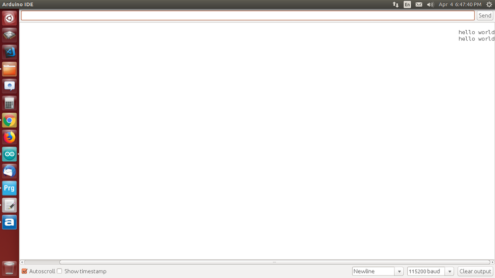

0690X0000089vMTQAY.png0690X0000089vMYQAY.pngNow I am able to receive data on uart 2 and display on PC's serial port.
But there is a long space between 2 data.
Please help me to solve out this I also attached snaps.
For an example, I send three times ''Hello world " from pc's serial port and STM32 reflect back on pc's serial but there is a long spaces between two data.
I share my receive callback function and snap of serial port of PC.

S.Ma
Principal
This seems to show that the provided usart examples needs to be closer to application needs and require xtra work for most dev people?
What do you mean by "a long space between 2 data" ? is there some time between typing "Hello world" in your console, and seeing it printed back ?
Could you try to use Rx complete callback, only to catch the information of Reception sequence completed, and to perform buffer reset, buffer analysis + scheduling of new HAL transactions (Transmit, and/or next reception) out of HAL_UART_RxCpltCallback callback ?
Please remind this callback is executed in Interrupt context.
2 other things to check :
  • Please note that current call of HAL_UART_Transmit_IT(&huart2, Tx_buffer, sizeof(Tx_buffer)) as shown in your code sample, will lead to sending of 100 bytes, whatever the size of entered string.
  • arguments passed to sprintf call seems strange in my opinion. Not sure to understand what you want to do here .
regards
Guenael
