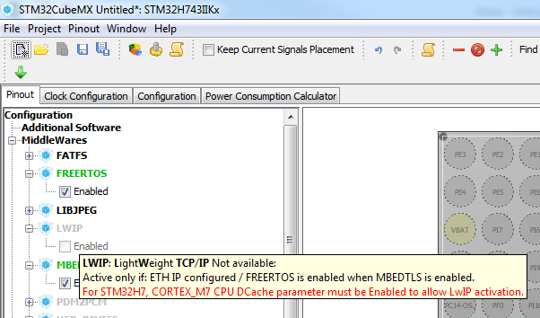

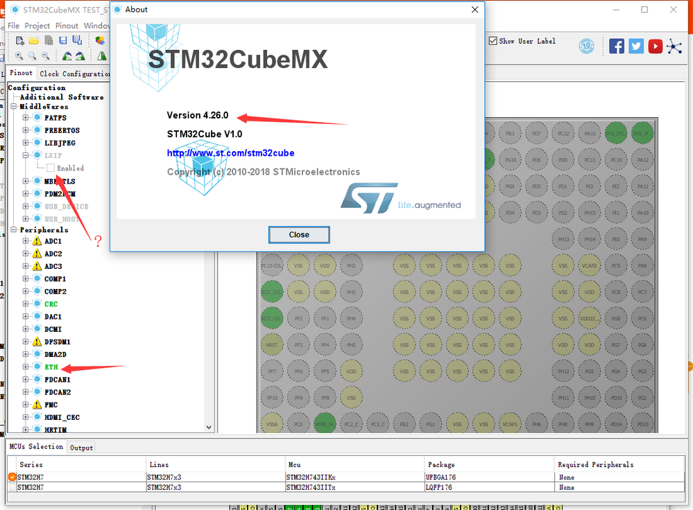

Unable to check LWIP in STM32Cubemx 4.26?
one V
Posted on June 28, 2018 at 14:03
Unable to check?
Imen.D
Posted on June 28, 2018 at 15:03
Hello
v.v.010
As mentionned in the warning for LWIP, it will be active only if the ETH IP and FREERTOS with MBEDTLS are enabled.
Also for STM32H7, CORTEX_M7 CPU DCache parameter must be enabled.
Please try this configuration, then let me know if it is OK.
With Regards,
Imen
Thanks
Imen

Posted on June 28, 2018 at 15:17
Thank you very much for your reply. You helped me very much.
