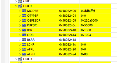

The static state of the UART TX pin should be HIGH
I mean HAL_GPIO_WritePin() or interaction with GPIOJ->ODR and readback via GPIOJ->IDR

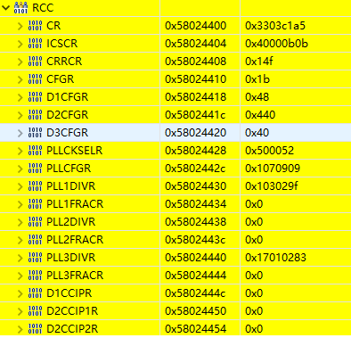

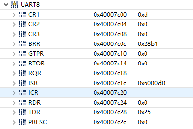

Check the settings in RCC, GPIO and UART8 peripherals, inspect the registers.

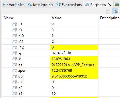

Anything running in the M4 core that might interfere with what the M7 core is doing?
You're checking the right pins? The code is running and not crashing or faulting?

After HAL_GPIO_Init(GPIOJ, &GPIO_InitStruct); I think should not add  HAL_GPIO_WritePin(GPIOJ,GPIO_PIN_8,1) ?
In my debug gpioj run as
In my register D0/D1 as(i dont know its same thing o no)
which part of rcc should i check
uart 8
