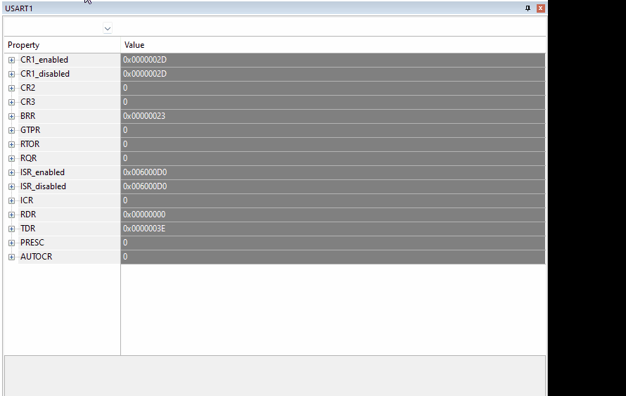

[NUCLEO-U575ZI-Q] USART1 unable to enter receive interrupt when i enable the trustzone.
李放.1
USART1 work in the non-secure world,it only can send data but not receive data.
You can see the RDE register is changed,but the usart receive interrupt is not triggered

mathieuM
I have a similar problem with USART3 as non-secure with TrustZone. I saw you resolved the thread, but what was the problem/solution to this?
Thanks,
