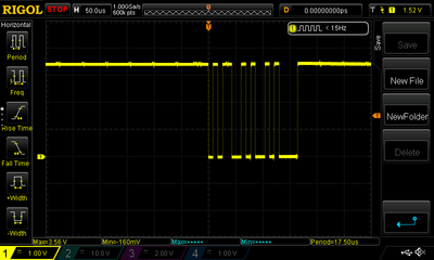

Here's a picture of the signal received on RX pin.
 Signal seems OK.
