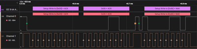

I'm using stm32f103c8 and PCA9685 devices. I'm trying to send data to PCA9685 via I2C bus. I send data using I2C_DR register. But when i write a data to I2C_DR register it sticks to it. After the data is send thee I2C_DR register should be cleared but it wont happen in my code. I have no idea why this is happening. This is what i see in logic analyzer.

It's a register, the act of writing it pushes values data into combinational logic and flip-flops internally. It's not designed to be used as a memory cell, or for you to RMW values into it
I2C1->DR |= data << 1  ; // to set PWM frequeency we set SLEEP bit 1 (PCA9685 datasheet page 24)
WHY???
Write the value I2C1->DR = data << 1
2 REPLIES 2
WHY???
The problem is i used I2C1->DR |= .... It should be I2C1->DR = ....
