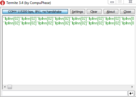

In my code i'm trying to send data over CAN and USART .
CAN is working as i have tested with my analyser but over USART sending some junk data.
is there any possibility that CANBUS and USART gets conflicted.i'm using STM32F7 and in that i'm using CAN1 and USART3

I'm not doing anything other than printing data over UART even i have commented the CAN_Init() but still i'm having that problem
