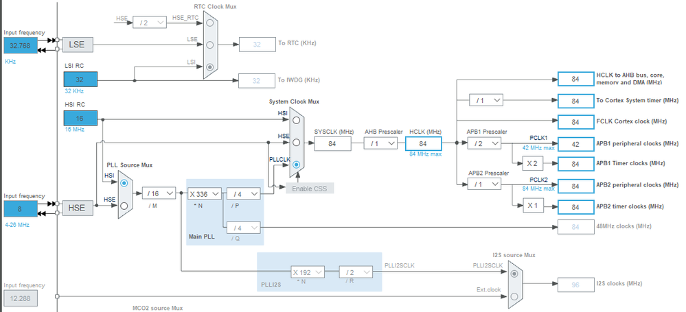

I setup my custom board with STM32F401RE. I am using the HSI a the moment with configuration shown in the image below. All I am doing is printing some lines using this function on the UART2:

Baud rate, yes typically 3-5% error is tolerable, but the dividers should get you to within 1% as I recall.

That is a bit odd. The HSI can be off a bit, I don't recall a Trim or Calibration setting for it. The HSI_VALUE define should be fixed.
The PLL powers from the VDDA, might also check the VCAP pins/caps.
Should be able to export HSI or PLL clocks via MCO PA8 to check with a scope.
For HSE there can be a mismatch vs external crystal if HSE_VALUE define is not reflective of reality.

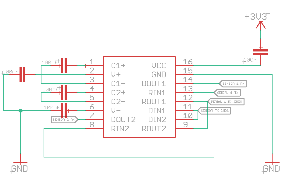

Turns out the loopback mode works fine on UART1, UART6 but not UART2. I verified this with the Nucleo F401 board too. Somehow, the loopback does not work on only UART2. Is this the limitation of this UART ports?
However, the reason other UART did not work is because the MAX232 does not convert CMOS to RS232 and vice versa. I guess it is either broken or there is a wrong connection on the board. Here is how it looks like:
  • Is it fine to connect RIN1 and RIN2 to read from either of these RS232 lines?
  • ROUT1 and ROUT2 are connected together to get the same signal.
  • Is it fine to connect DIN1 and DIN2 to split my RS232 output lines?
What are the consequences of connecting 2 different lines together?
I wouldn't do it this way, ROUT1 should be able to drive two CMOS input buffers, no idea what the defined behaviour is for the buffers to be run in parallel.
Either of which two lines? You only have one input source.
The original MAX232 had a bandwidth limit of about 1Mbaud, but could be lower depending on capacitor choices.
