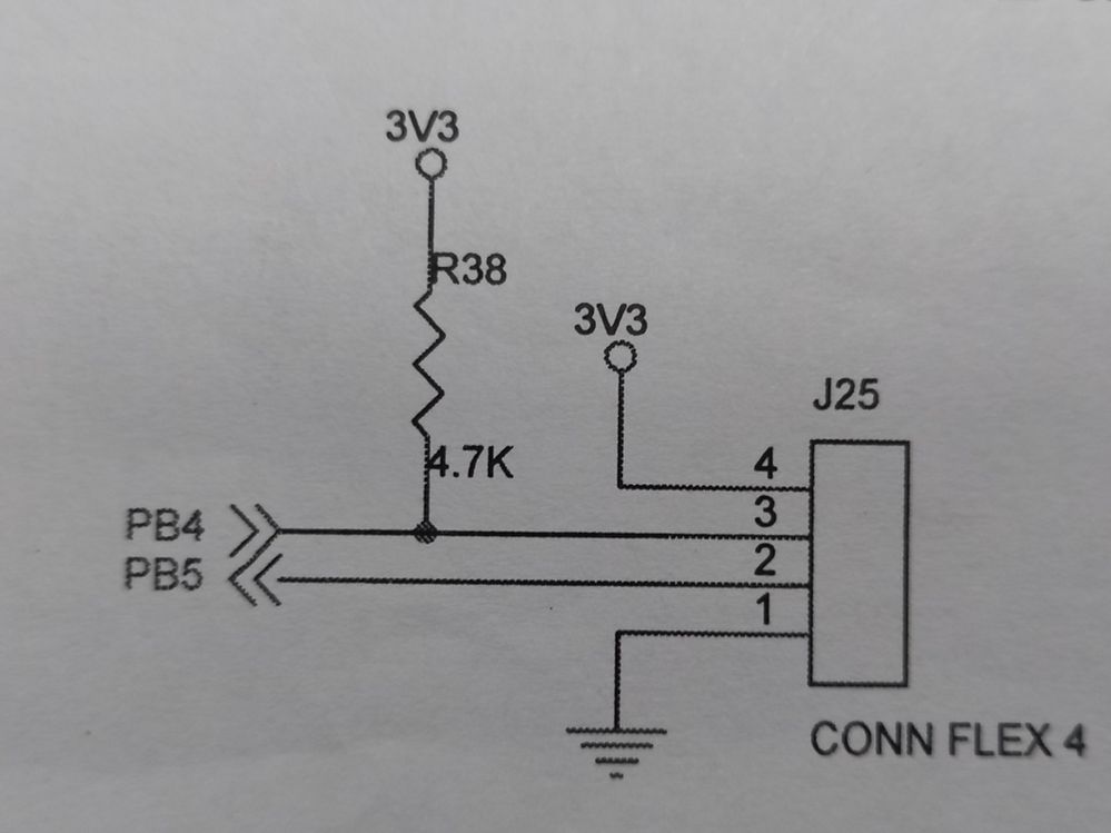

  • I am trying to commuicate between two boards through UART.
  • One board is nucleof4 and other board is a processor.
  • Im sending a data from nucleo to other board(where data gets displayed) through HAL_UART_Transmit(&huart1,(uint8_t*)"Connect",sizeof("Connect"),100);
  • The problem that Im facing is data is getting  displayed on pressing reset button on nucleo several times.
  • The communication is not smooth
  • J25 connector as shown in image is where im interfacing my nucleo f446re with processor board.20240910_144134.jpgThank you

So the PB4 / PB5 is on the STM32F446RE or something else?
Which UART
What is wired to what, diagram the actual connectivity, perhaps the initialization code.
What does "The communication is not smooth" mean? You're sending NUL characters in the very limited code snippet you've chosen to share.
  • So the PB4 / PB5 is on the STM32F446RE or something else? PB4/PB5 is of other processor board.
  •   Which UART  USART1  PA9/PA10 of stm32f446re to PB4/PB5 of other board.
  •  What is wired to what, diagram the actual connectivity, perhaps the initialization code.     PA10-rx to PB4-tx  and PA9-tx to PB5-rx and ground

Have you put a scope or logic analyzer on it? And looked at the signals?
If you're resetting the STM32F446RE is it getting to main() ? Getting stuck in Error_Handler() ? What would prevent it from getting to the code that does the HAL_UART_Transmit() ?

You need to show your full schematics, and your code - see:

  • Sending a string "Connect" through uart1 of nucleo to mini 6045 processor
  • Below is the processor code ,its pinout to where im connecting nucelo uart1 i.e PA9 and PA10
