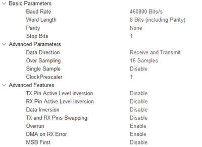

I use two Nucleo-G0B1RE to communicate with each other using UART. UART5 of the master board is connected with UART1 of the slave board and both of the UARTs use DMA receive. When I first pressed the reset button of the slave board and then the master board, they could communicate successfully, but when I first pressed reset of master board and then slave board, the slave could transmit message but the master could NOT receive it. The only difference is the Power-on Sequence. what is the difference between UART detected another UART as soon as it is power on and UART detected after a short time.

If the receiver sees an invalid signal, it may enter an error state which you have to address before receiving more characters. Resetting mid-way is likely to push out an invalid signal on the UART TX line.

Hello @JAcksonPi
Could you explain "both of the UARTs use DMA receive"? Could you share your UARTs configuration and DMA initiation?

UART5 of master is connected with UART1 of salve. I used exactly the same program for both MCUs. Maybe I should add some statement to continuously detect if slave exists in master code?
‎2023-11-26 5:50 PM
When master is initialized first, it could transmit correct message to slave and salve could send correct message (as least in txBuf) ,however master cannot receive this response. Maybe I should continously detect slave in while loop of master code.
