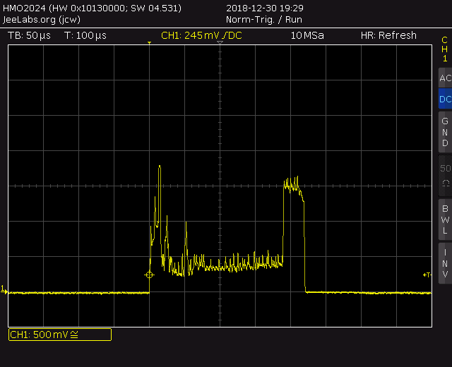

I've been trying to get an STM32L031 to periodically wakeup with minimal power consumption. The specs say it can standby at under 0.5 µA, which I can confirm, but also that it can wake up within 65 µs, which I cannot reproduce. I'm seeing a 1.6 ms delay with 300..400 µA current consumption. This seems to indicate that the µC is waiting for Vrefint to stabilise, even though I have the FWU bit set. Below is a minimal example which still does not wake up in 65 µs:

New results, and frankly, I'm not sure how to interpret them - I now get more like 180 µs delay, much closer to the expected 65 µs, and a good deal better than the 1.6 ms reported earlier.
Here is the new code, with an LED attached to PA1, so I can see when the main code starts:

jcw
And here's the matching scope shot with the current consumption readings:
