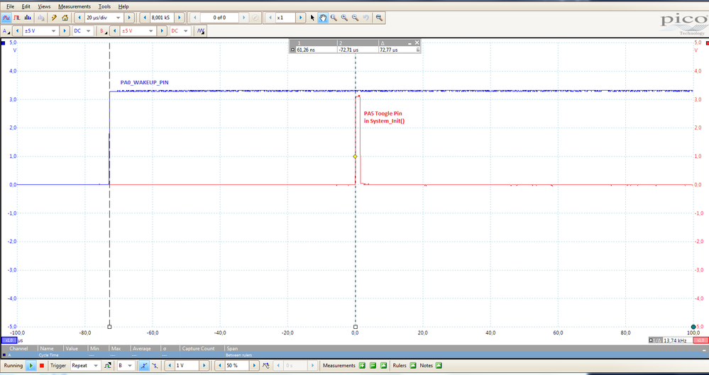

Here my results by using my method (PA0 as external wake-up pin on PA5 toggle into system_init()) but it should be the same by using iwdg reset. I will check it.
I capture 73µs @ VDD=3.3V with Fast wakeup enabled. And maybe need to take the code added into System_Init() to configure PA5 clock, and IO register. Maybe 20 cycles to remove at 2.1MHz. 9µs to substract ie 73-9 = 64µs

jcw
Great to see this, many thanks. You're doing the work in "SystemInit()" which I have in "main()". I also do not use libopen, but my own code, and it also uses direct register access. The differences, as far as I can tell, should be at most a few instruction cycles - I'll investigate further. Then again, 100 µs is not much @ 2.1 MHz, so maybe the remaining 100 µs I'm chasing should just be treated as "startup overhead".

Ok, I''ve got the startup time to toggling an I/O pin in main down to 85 µs. Did this by removing most of the code in the startup.s file for L031, not calling SystemInit, and not even initialising BSS (just as a test). My demo is cycling nicely at 0.8s, with standby and the IWDG waking it up again.
My conclusion is that the remaining 20 µs are down purely to the few remaining instructions needed to set up the stack and I/O pin (and some variation in that 65 µs spec). So all is well - this is indeed the amount of time it takes to get an L031 out of standby. All conform to specs.
