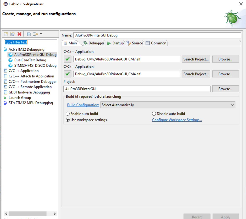

2019-08-12 4:47 PM
I use the debugger icon to set up a debugger configuration. You can disable one core from downloading by not selecting the corresponding .elf file.
You are using IAR so I am not sure and it might be different. But when you download your code the start.s file is executed before main is called. Set a break point in start.s at the entry point and step trough it.
