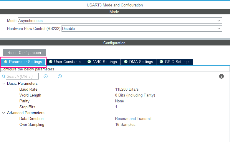

  4. In Pinout view tab, check that USART3 mode is configured to Asynchronous, PD8 is connected to USART3_TX and PD9 is connected to USART3_RX.
  5. Click on USART3 button, select Parameter Settings and make sure the parameters as shown in the below figure.0693W00000QNhhNQAT.png

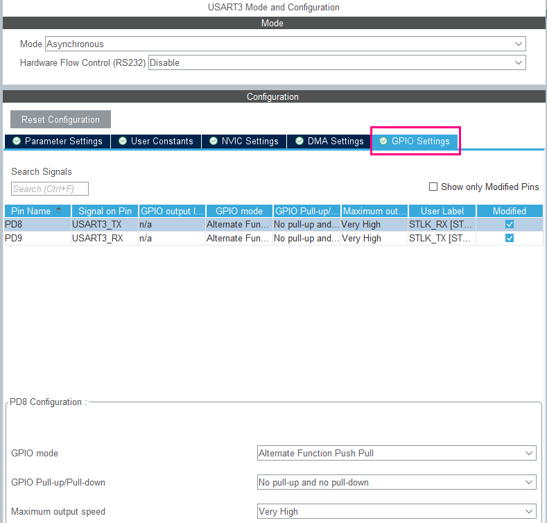

  6. Select GPIO Settings and make sure the configuration GPIO as shown in the below figure.0693W00000QNhhrQAD.png

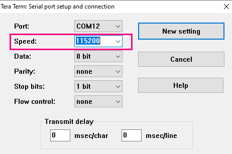

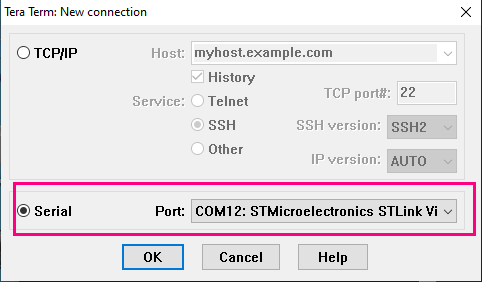

13.Open TeraTerm, select file>New connection and choose the right Port as shown in the below figure.0693W00000QNhiBQAT.png 14.Select Setup>Serial port setup and connection and modify the speed to 115200 as shown in the below figure.0693W00000QNhifQAD.png 15.The TeraTerm displays Hello Worlds !!! string confirming you were able to program and use RS232.
