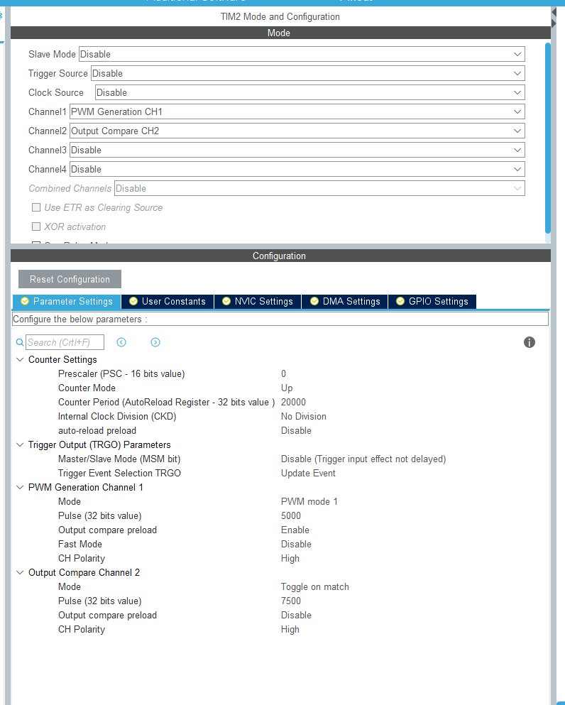

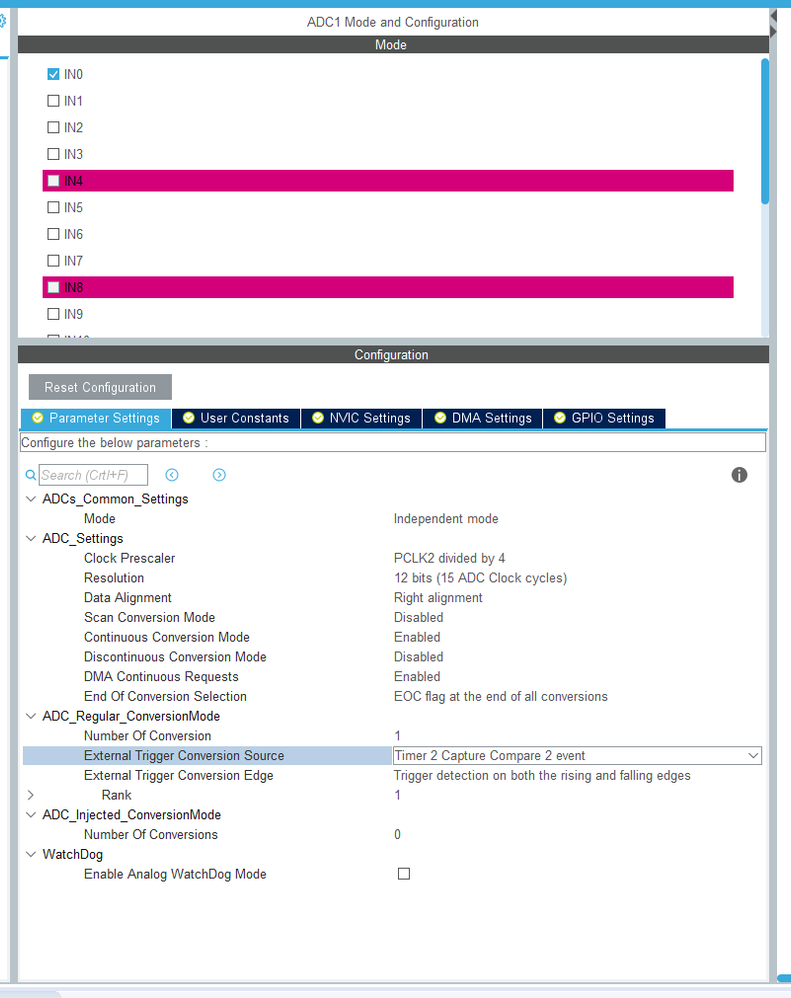

Anyway, I've got a PWM output from TIM2 CH1 (200us perioud, 25% D.C.) and I have another PWM from TIM2 CH2 with 35% Duty Cycle (now currently set to OC mode but toggles at the same time). I want to enable the ADC through DMA to capture 50 samples from the falling edge of TIM2 CH2. The ADC is set up to be 1.8Msps. According to RM0410 Rev 4. 439/1954 I can indeed use TIM2 CH2 as an external trigger, but my question is how? I previously got this working just using interrupts and then enabling the ADC in the HAL_TIM_PWM_PulseFinishedCallback after checking the correct timer and channel source, but this took way too long and used up the CPU more than I wanted. I've made multiple attempts at solving this but my latest has been this:
Start ADC DMA in the main, enable the ADC external conversion source as Timer 2 CC2 event and then the trigger event selection TRGO as "Update Event"

Here are the configurations for the Timer and ADC:

CubeMX configurations for completeness

It is definitely possible according to the reference manual. You can try setting the EXTSEL field in ADC->CR2 either to TIM2 CH2 or TIM2 TRGO and set the master mode field in TIM2->CR2 to OC2REF. To get a trigger on the falling edge, use the other PWM mode and invert the channel output polarity.
