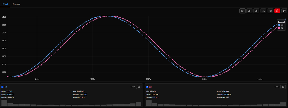

Hi, I need a little explanation about what is wrong behind my reasoning..
I am using STM32F411. reading, two inputs of ADC in scan mode over circular DMA triggered via TIM2 update event.
TIM2 is triggering ADC at 100KHz, so I have 50Khz sample rate per adc input. At input of both ADC channels I connected signal generator feeding 1Vrms sine @20KHz.
Everything works ok, I am using printf of both channels over (USB-CDC) as  and I can see two sinusoide signals on serial plotter. I am using this serial plotter:
https://web-serial-plotter.atomic14.com/
Now the problem and confusion starts here:
If I change only TIM2 frequency to 10KHz, I am getting 10X lower sample rate also (now 5KHz pre channel, all checked with Logic Analyzer), but I still can see clear 20KHz sine at serial plotter, without degradation and this contradicts Nyquist theorem...
How is this possible and what I am missing?

You are misunderstanding Nyquist, there is no obstacle to to see 20.1 kHz sinewave as 100 Hz if sampling adc at 10 kHz. It's called aliasing. Same happened to 30.1, 40.1 etc. This is why anti aliasing  filters were invented

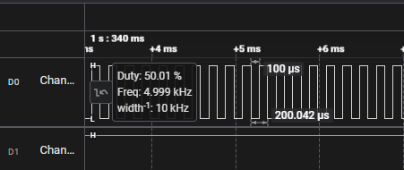

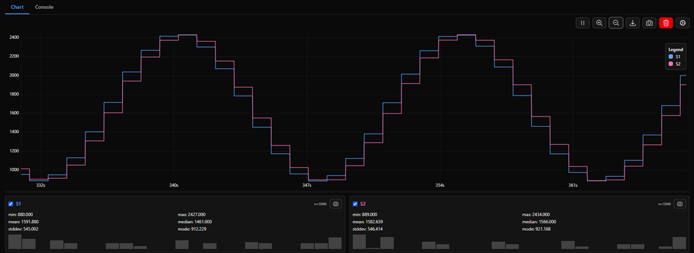

Well I can see I am missing something here...
I am fooled by serial plotter, it prints slowly, it needs about 12 sec to print one sine cycle.
This is what I see with 20KHz input and only 10KHz sample rate.

This is my logic analyzer screenshot of LED_BUILTIN gpio:
So could anyone help me learn what Im missing?

This is with everything else the same, just TIM2 set to 1Hz, for experiment purpose.. So what I should conlude from this.?
PIcture tells you that at the adc input present  non modulated sinewave unknown frequency,
but Freq.(Hz) = 1 x N + 1/15 = N +  0.066, where N -> 0....infinity
Hi, what do you think now, as I see TIM2 is working correctly.
I don't think all samples are making it into your serial plotter, thus the output is showing up as a sine wave, but not with the frequency you expect. That would be the expected behavior. I would look into how you're getting data out. Send it in chunks, not one at a time.
Printf hooked up to CDC directly is not a robust output mechanism, especially not with a 5ms delay between outputs.
