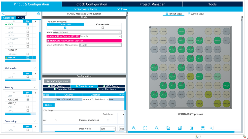

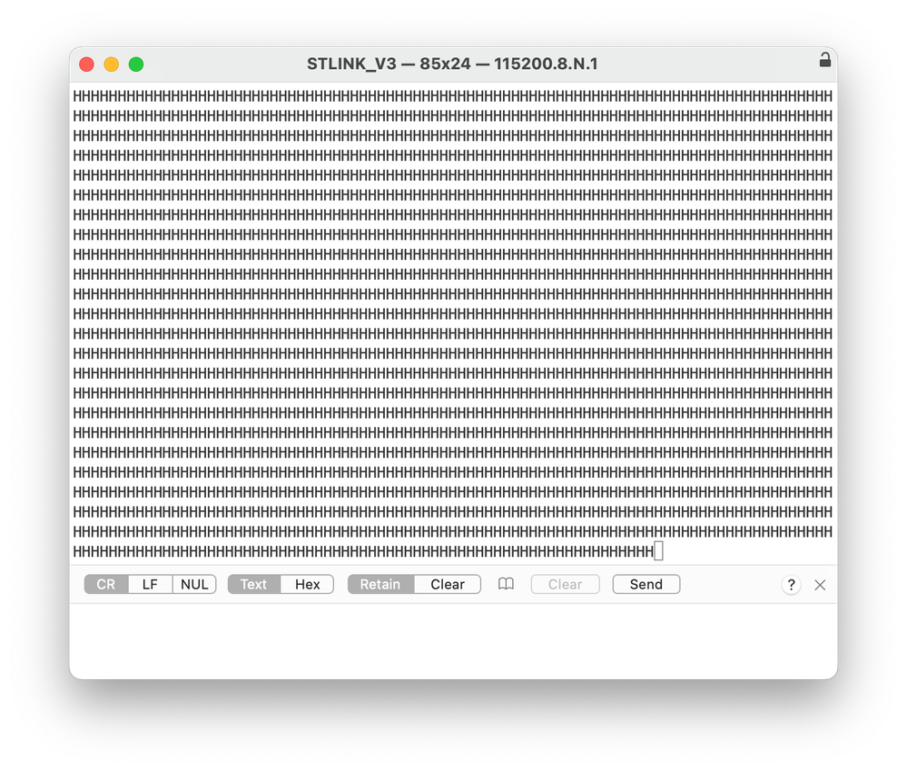

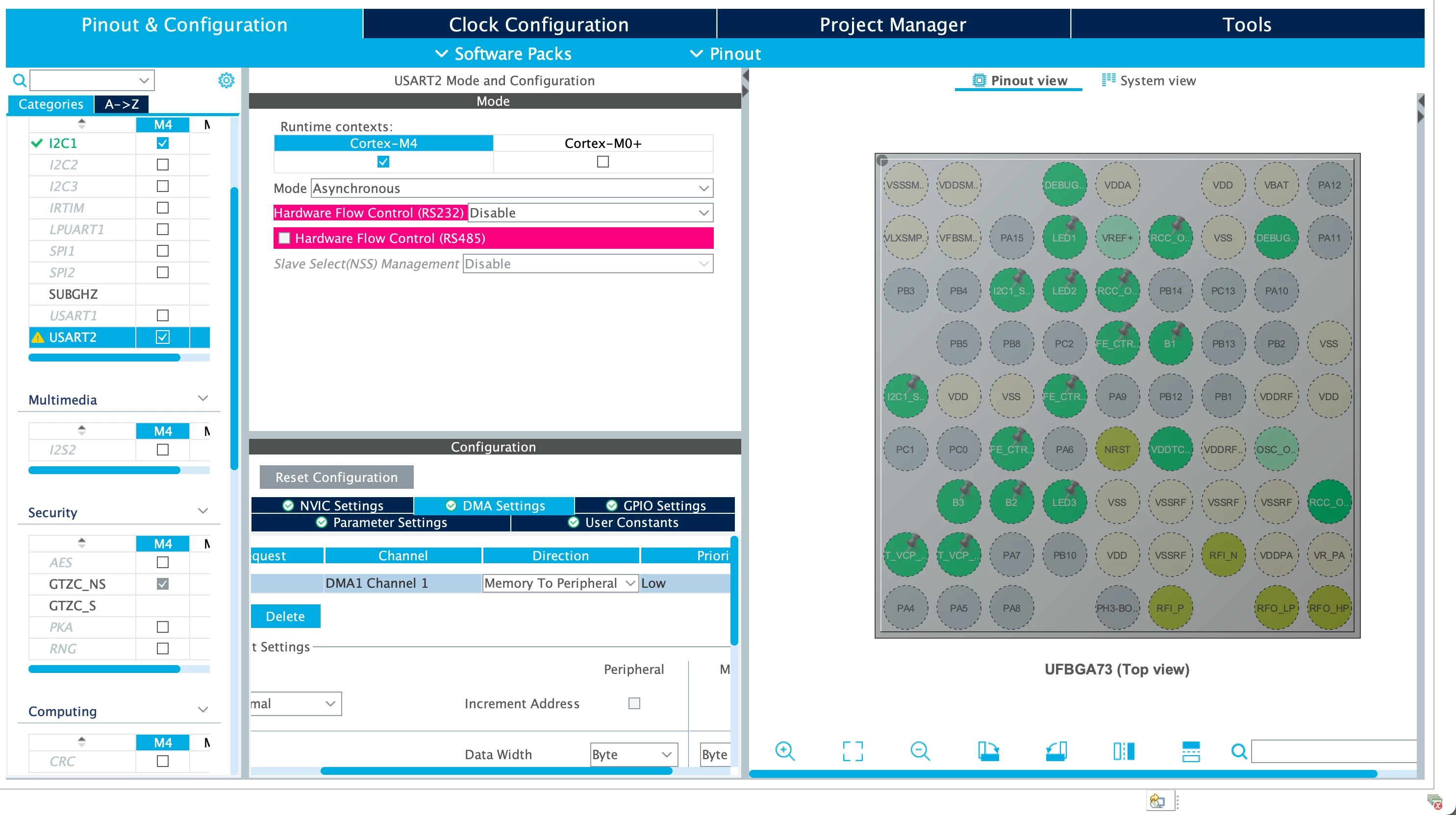

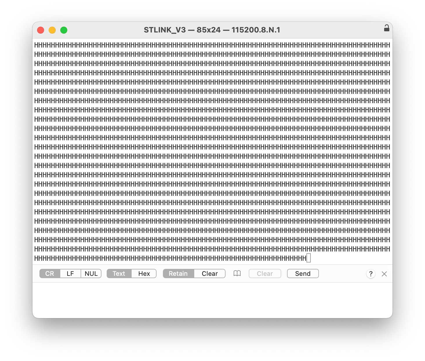

This is my first time using STM32 so I'm kinda lost about this HAL and LL things. I tried this tutorial that I could find in the internet, but my DMA settings is different with the tutorial (in the tutorial it shows DMA stream but mine is DMA channel so I can't use the LL_DMA_EnableStream and LL_DMA_DisableStream
Edit 1
Used LL_USART_TransmitData8(USART2, receivedData); but now I only got bunch of H's :\
