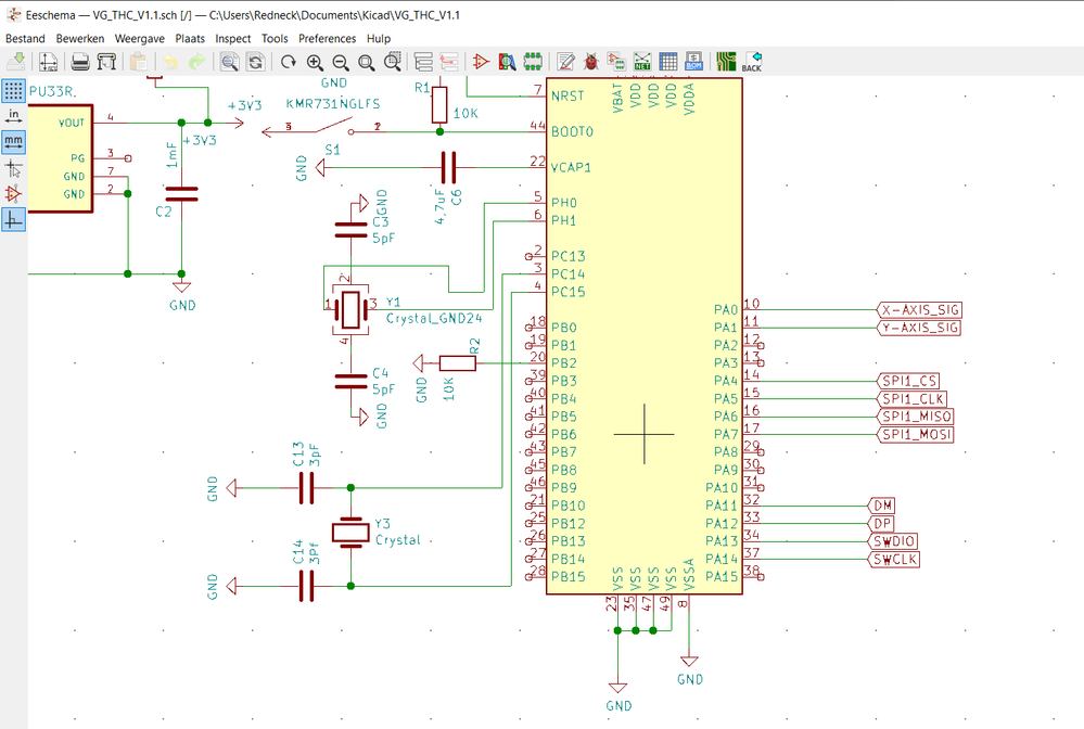

Update,
Just came to the conclusion the 4 pad crystal wasn't correctly placed, it was 180 rotated. I couldn't see where the pin 1 of the crystal was located so i just swapped it.
I made a quick Custom HID program and it worked.
After this correction my device works as designed. Thanks Tesla to pointing me to the clock.

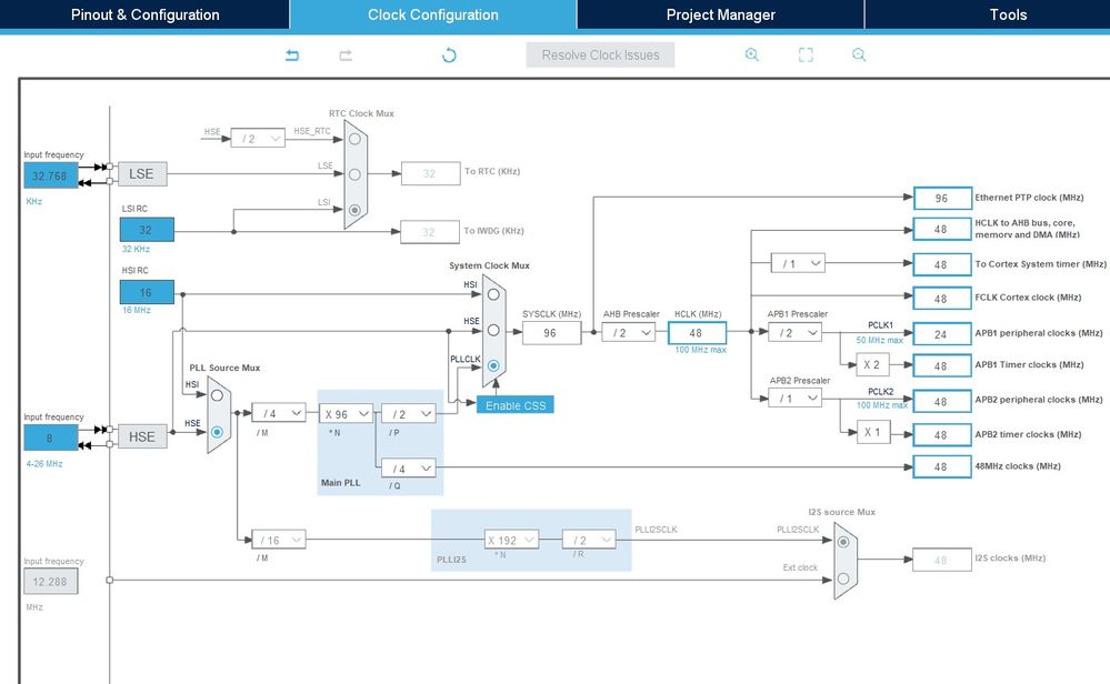

I have been Checking my HSE clock again on the RCC_MCO1 pin the output is 16.13 MHz , but USB custom HID needs 48 MHz. So something is of.
I configured the clock options through cube ide.
Been reading through datasheet of the F411 and some articles about crystals.
But to my knowledge i have done the setup right, maybe someone see an error
The code generated by cube ide below.
Hopefully someone could push me in the right direction.

if (HAL_RCC_ClockConfig(&RCC_ClkInitStruct, FLASH_LATENCY_2) != HAL_OK)
Error_Handler();

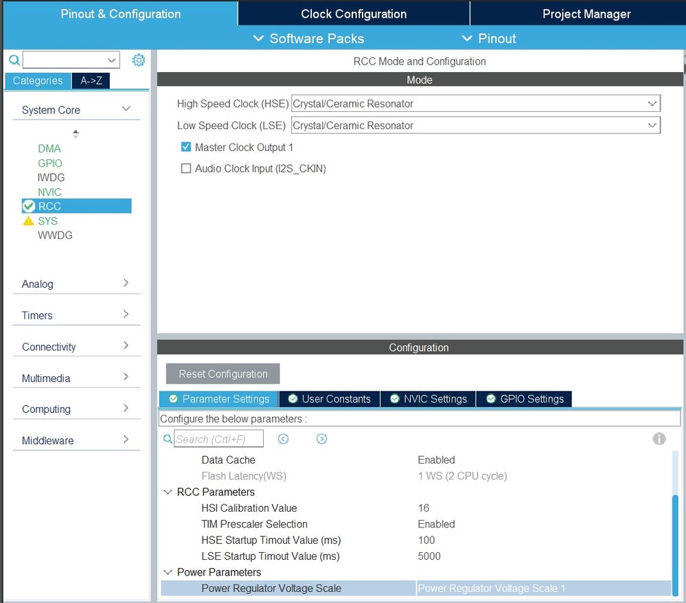

and the clock config in Cube ide

Banging my head on the keyboard here;)
My while loop doesn't run, so i suspect my oscillator isn't starting. My ADC does run but seems like ADC is not clock dependent.
Does the HAL layer work regarding clock settings?
If i select HSI i can measure the 16 MHz freq.
Just for future pcb design, is the LSI mandatory or can it be left out of the design.(for now it will be only a USB custom hid board).
Some help will be appreciated.
Thanks
Certainly seems like it's using HSI and not HSE. Does Error_Handler get executed? Put something in there so calls do not silently fail.
What crystal are you using? 5pF seems low.
