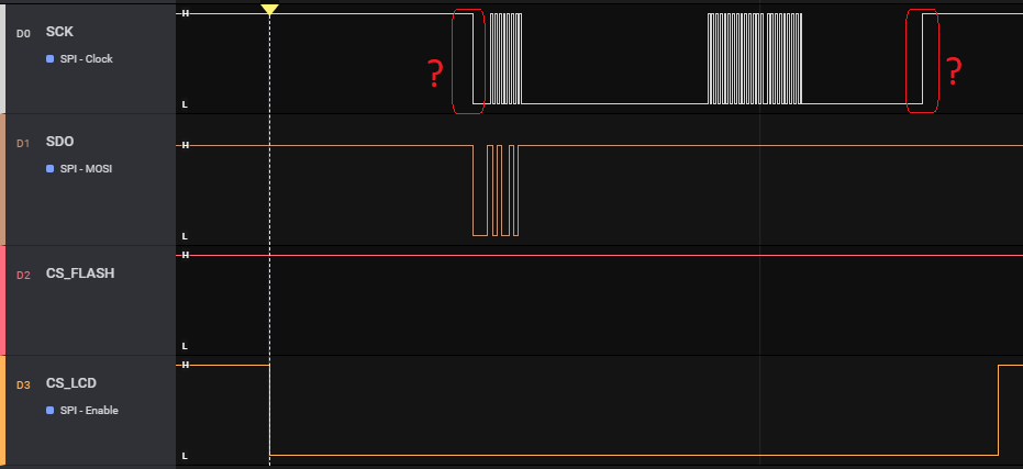

Init parameters:
  • CPOL=0 CPHA =0, so SCK level should be idling at LOW level.
  • Software NSS
  • Half-Duplex, master mode
Software: CubeIDE 1.9, CubeMX 6.5.0
Device: STM32F411CE
Issue:
  • Regardless of the clock config, SCK is high if the SPI module is disabled.
  • When enabling CS before calling HAL_SPI_Transmit/Receive, the slave sees SCK high, breaking the transfer.
  • After a Transmit, the SPI module is left enabled, holding SCK low, so next transfer will work.
  • After a Receive, SPI module is disabled, breaking SCK again.
The issue can be seen here:
waclawek.jan
When you disable SPI (by clearing SPE bit), SCK is threestated. If it goes up, it's because there is a pullup, internal or external.

waclawek.jan
If you don't like Cube/HAL's behaviour, simply don't use it. SPI is simple enough to be used normally.
DavidAlfa
Senior II
Enabling the pulldown resistor fixed the clock idle issue, Thanks!
