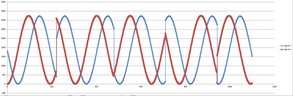

I use two ADCs, working together on two different signals.
These two signals have the same frequency and amplitude. They are shifted, Signal 2 has a phase of 90°.
The DMA put the converted values in an array. This array is printed circularly in the Debug Viewer.
I have one column of values for each signal.
The ADCs seem to work correctly, however I have a doubt: is it possible that the Trace is too slow?
Typically, I have this kind of result:

So you can see here that there is a gap, several values are likely skipped during the printing process.Here is the graphic output of the values from both ADCs.As you can see, this happens several times, but this left aside, the two signals are correctly treated.During the execution in debug mode, I have the message ''Trace: data overflow''.So I think it is just about the display of the values, but I wanted to be sure.Should I be concerned about this, or should I just assume that the values exist in the memory and the Trace just fails to show them properly?
If your trace runs concurrently with debugging over SWD, sure. Debug and trace are sharing bandwidth in this case.
Professional debug pods with real-time trace (ETM) will cost you about 1k bucks (€ or $).
Consider tracing (in your case) just useful for verification. Once the code-under-test is proven to work, turn tracing off.

Posted on August 02, 2016 at 15:23
Good to know, thank you :)
