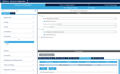

When I have this configuration with the SAI + DMA, I have no communication problem with I2C to configure the CODEC.
But I don't know where the DMA stores the values ? How to recover these values ? Do you have any information or documentation so I can better understand ?
Thank you
LCE
Principal II
Oh my... you need some basic tutorials!
CubeMX does just the basic setup for the peripherals.
You need to start the DMA transfers, by doing that you assign some buffers, and that's where you'll find the data.

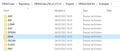

Look for some simple example code for your STM32, go through that step by step and try to understand that.
Of cours I'm a beginner... So you have a problem with theses people ? I just ask how DMA works or the documentation.
After your explanation, I can find an example of code with my evaluation card and thank you
But it's even better if I can find the principle of how DMA works, I've seen so many tutorials on youtube and code examples but nothing matches what I'm doing exactly.

@DYann.1 Here is the official ST tutorial on the DMA :   https://wiki.st.com/stm32mcu/wiki/Getting_started_with_DMA
And there are so many folks ready to patiently help beginners .... they just expect something in return :) Care and share goes both ways.
ST official training on STM32L5: https://www.st.com/content/st_com/en/support/learning/stm32-education/stm32-online-training/stm32l5-online-training.html
Enjoy!
Thank you, I'll look at these 2 links.

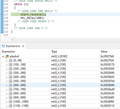

After reading the SAI and DMA documentation, I coded a piece of the program. I think I'm recovering data. Here is the code what do you think ? Thank you for your help.

Here is what I see in the table :
Pavel A.
The last image "Expressions" is indeed confusing. The values in the rightmost column are not values but addresses of 100-item slices of array playbuf.  If you expand any slice it will show the actual array elements.
This is how the Eclipse debugger behaves ((
LCE
Principal II
For simple testing without the Codec, you could directly connect SAI data output to data input, then compare transmit buffer ("playbuf")  with the receive buffer.
Start with a simple signal in playbuf, like playbuf[i] = i; i++;
