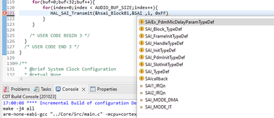

I found an example on the internet of a project but I don't understand the usefulness of using a Timer 7. Could you tell me why ? Thanks in advance.

It's probably to do a clocking in µs ?
Yes, exactly this.
DYann.1
Senior II
Yes but only use in the HAL_TIM_PeriodElapsedCallback and nothing else (the usTick) and apparently the timer works by itself and we don't use it manually to recover the data. I don't see the use of the Timer yet the author says : 'This function Should not be modified, when the callback is needed, the __HAL_TIM_PeriodElapsedCallback could be implemented in the user file'
But there is no callback so why the Timer is necessary ? Thank you for your helps.
If the random code you found needs to interrupt at 1 MHz, I would say maybe find a different code to go from.

This looks like just copy/paste from some place in the template code; the HAL_TIM_PeriodElapsedCallback is defined there with "weak" attribute.  In your code it is exactly the "implementation in user file". This function *is* the callback from timer interrupt handler.
/* Example why bad comments are worse than no comments */
In this case, I don't need to implement a Timer I guess since there is no callback.

I tried to adapt the code to my microprocessor but I don't know which one to choose? In your opinion ?
After me the SAI (equivalent to I2S) work with 3 possible modes: IRQ, DMA and IT. Probably, I'll start with IRQ to make it as simple as possible.
I do this but I get a warning. Do you know how to call the SAI function to retrieve the values ?
Pavel A.
Source of the ST library is available. Please read the documentation in the library files (.h and c) , it is helpful. The compiler warnings are very helpful - please read them and try to understand the reason.

Just to need the type and now It's correct.
  uint8_t txData[16] = { 0, 0, 0, 0, 0, 0, 0, 0, 0, 0, 0, 0, 0, 0, 0, 0 };
  /* USER CODE END 2 */
  /* Infinite loop */
  /* USER CODE BEGIN WHILE */
  while (1)
    /* USER CODE END WHILE */
	 start_receive ();
	 for(buf=0;buf<32;buf++){
		 for(index=0;index < AUDIO_BUF_SIZE;index++){
			HAL_SAI_Transmit(&hsai_BlockB1,txData,1, 0xFF);
But in the example found on the internet the person uses the TransmitRrecieve command.
HAL_I2SEx_TransmitReceive(&hi2s2, &i2s_zero,&i2s_buf[buf][index], 1,0xFF);
Where to find in the documentation to find the right command to retrieve the values ?
