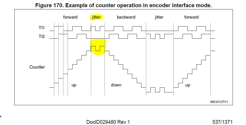

I'm using TIM5 for quadrature encoder counter. I had seen some examples of using CubeMX to do this.
Since I'm interested in quadrature counter, i.e counting 4X the resolution of the encoder disc lines per revolution as generally the case, so I used both input channel TI1 and TI2. The question is why people configured the two input channels trigger polarity as Rising Edge but not Both Edge? Isn't that the Quad counter should count on both edges of each channel (total 4 counts per one period of one input pulse)? In fact the RM0432 Reference Manual page 645 for register MITxCCER says:
11: noninverted/both edges
Circuit is sensitive to both TIxFP1 rising and falling edges (capture, trigger in reset, externalclock or trigger mode), TIxFP1 is not inverted (trigger in gated mode). This configurationmust not be used for encoder mode.'
Anyone know why the polarity must be set to Rising Edge instead of Both Edge?
A screenshot below was borrowed from other posting member on the same subject, and I posted below as a reference.

‎2017-09-06 7:11 AM
Hello !
The encoder(MCU) takes as Input two digital lines .
Theese lines carry 2 bit of information.
The information is just edges and states with 90 deg. phase difference.
The encoder gives an output data also with two bits of information
One bit is the counter revolution and the other bit is the direction.
It is not possible to have 4x resolution without lose the direction.
So if you detect both edges at one channel there will be an ambiguity about the direction because the edge from other channel will be occur at 180 degrees... in the midle of the two detected edges.. and so on.
In case the polarities are different the direction changes (it is not something abnormal)
About 'Both Edge selection' in STM32 cube i think also that must be eliminated.
Regards
vf
‎2017-09-06 10:33 AM
Hi VF,
It is not possible to have 4x resolution without lose the direction.'
4X resolution means the encoder counter has an output count of 4X the resolution lines on the encoder disc or scale; i.e. a 1000-line optical disc will generate a total 4000 counts in one turn of the disc. This is a very common standard in the motion industry.
So if you detect both edges at one channel there will be an ambiguity about the direction because the edge from other channel will be occur at 180 degrees...'
This is not quite true. In Encoder Mode, the user can select to count only on one input, TI1 (2X resolution) or TI2 (2X res) , or both inputs (4X res), by setting SMS bits of TIMx_SMCR register, and regardless of counting only one or both inputs the counter always triggers on BOTH EDGES, no option about this.
The Direction is determined by the logic state of the other input (90* out of phase from the one having triggering edge). Review the Encoder Mode in the Reference Manual rev1, Figure 170 will show how it works in 4X resulution (4 counts in one period of input channel).
Best,
Brian

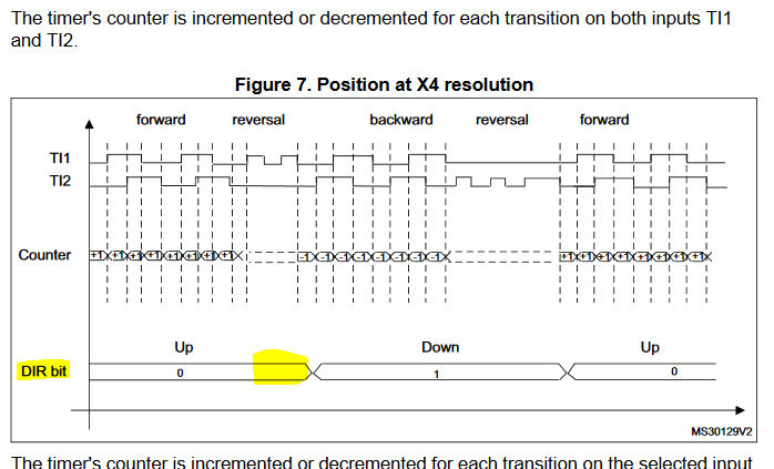

‎2017-09-06 10:01 PM
Hi Brian!
what do you mean ''a whole pulse''? A full period of TI1 or TI2? I mean the positive only part of the period.. period TI1 = period TI2 because the outputs of the encoder going to TI1 and TI2 are mechanicaly connected (90deg diff)
I use this pulse as the nominal encoders resolution. Pulses Per Revolution (PPR) .
You use as resolution the Counts Per Revolution. (CPR) . I will never say that is wrong but must mention the details.
>>>direction is ambiguity only within a 1/4 of the input pulse period, just as the encoder count resolution''
Look at this figure (
AN4013
STM32 cross-series timer overview) The ambiguity is not 1/4. (hilighted DIR bit and gap)
Just make an emulation with mind, what will hapen if we change the direction of a rotary Q encoder every 1/2 (2x1/4 , as you wrote the ambiguity is 1/4)
The uper left ST logo leads to community and i didn't find any other way than having an opened browser window to st.com
Best Regards.
vf
‎2017-09-08 12:04 PM
VF,
So you said there was direction ambiguity for half of a line resolution of the encoder disc (a line resolution is the spatial includes the dark and clear of the lines). No, in quadrature encoder both the count and direction have resolution within ¼ of the lines resolution, not ½ as you think.
Reference to Fig 7 above and during the time t that you highlighted, TI1 doing up, down, up while TI2 stays low, the counter went through 3 events: +1, -1, +1, although in the Fig 7 it doesn’t show the counter is counting during the highlighted zone for some reasons, but I’m pretty sure in reality it counted +1, -1, +1 and the DIR bit changed accordingly.
Best,
