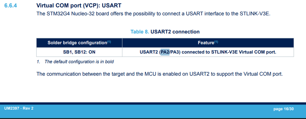

I am driving a Neopixel LED with a PWM signal in DMA mode using a timer. Even though all variables are the same, my code works with timer 3, but the same code doesn't work with timer 2 with the same timer configuration. Why could this be? I checked for a 16-32 bit difference, but they say it's not related to that. I have an STM32G431 Nucleo board. I tried all pin configurations for timer 2 channel 1, but it didn't work. İf it's normally and ı cant use this for neopixel, I will change timer but I use other timers for different jobs with  different frequences. But ı dont thinks so.

@Andrew Neil wrote:
Have you checked that the Nucleo board doesn't have something else on PA2 ?.
Yes, it does:
https://www.st.com/resource/en/user_manual/um2397-stm32g4-nucleo32-board-mb1430-stmicroelectronics.pdf#page=16
via: https://www.st.com/en/evaluation-tools/nucleo-g431kb.html#documentation

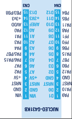

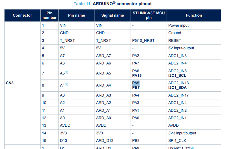

@cereyanmühendisi wrote:
Sorry for late answer. I dont use PA2
Sorry, yes - it's PA5
But do you have the board correct configured for that?
I cant understand, did u mean ı confused pins? if it is, probably no. Because ı can take basic pwm signal with same pins. I use this picture.
