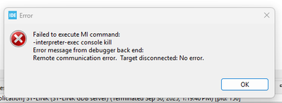

When I stop with the red button and try to start again, i got:
Then i  could load again.
