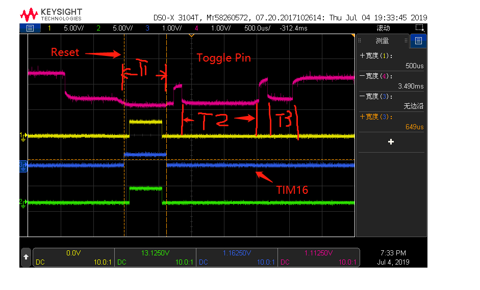

‎2019-07-04 4:19 AM
OK, so in the debugger, when there is no output waveform, stop the code execution (break); check, if the TIM CNT register is changing, i.e. if the timer is running; then check if the CCRx register is set to nonzero and below ARRx register; check if the given channel is set properly in CCMR and enabled in CCER; and then check if MOE in BDTR register is set.
‎2019-07-04 5:03 AM
I have confirm below :
- TIM CNT is changing , because TIM can generate three UIF interrupt
- CCRX register set nonzero value ,and below ARR register .
- MOE in BDTR register is set
- channel is set properly in CCMR ,enabled in CCER
you can see my upload pic ,the left vertical yellow is time start point ,from top to ​bottom, four lines ,
- the top line ( red line ) pin waveform , in update interrupt hander ,I pull up ,when I pull down config TIM complete ,enable TIM .
so, TIM is running ,otherwise , can not generate interrupt three times.
- the blue line is OC waveform during T1, the TIM is running, only T1 generate OC wavform once, T2,T3 not generate.
If convenient for you, I send my source code to you .
