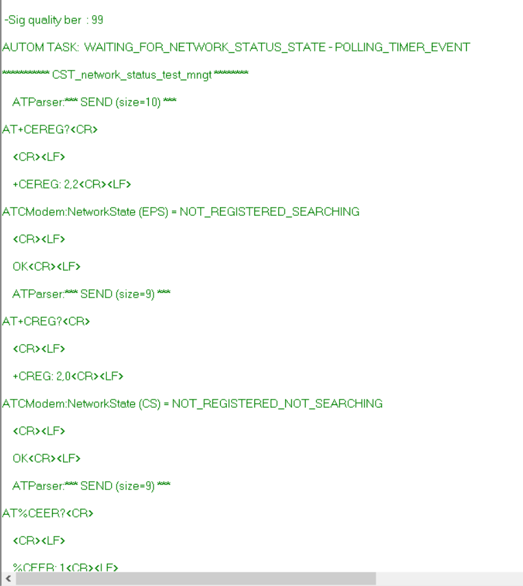

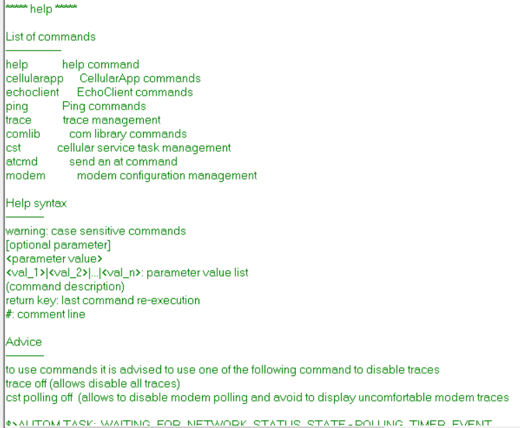

I am having problems connecting to the network through UART. Is there someone who can help with the steps? Does it have to be through cli (image)? I have tried many times but it ends up sending at command to itself (image 2).
