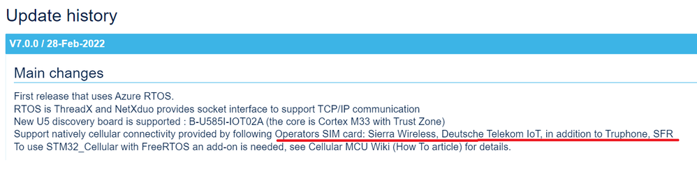

I have got hold of one evaluation board.
This part of its release note mentions what sim card can be used with it. I wonder if I can use any other sim card with my local service providers, which is not included in the mentioned list.
