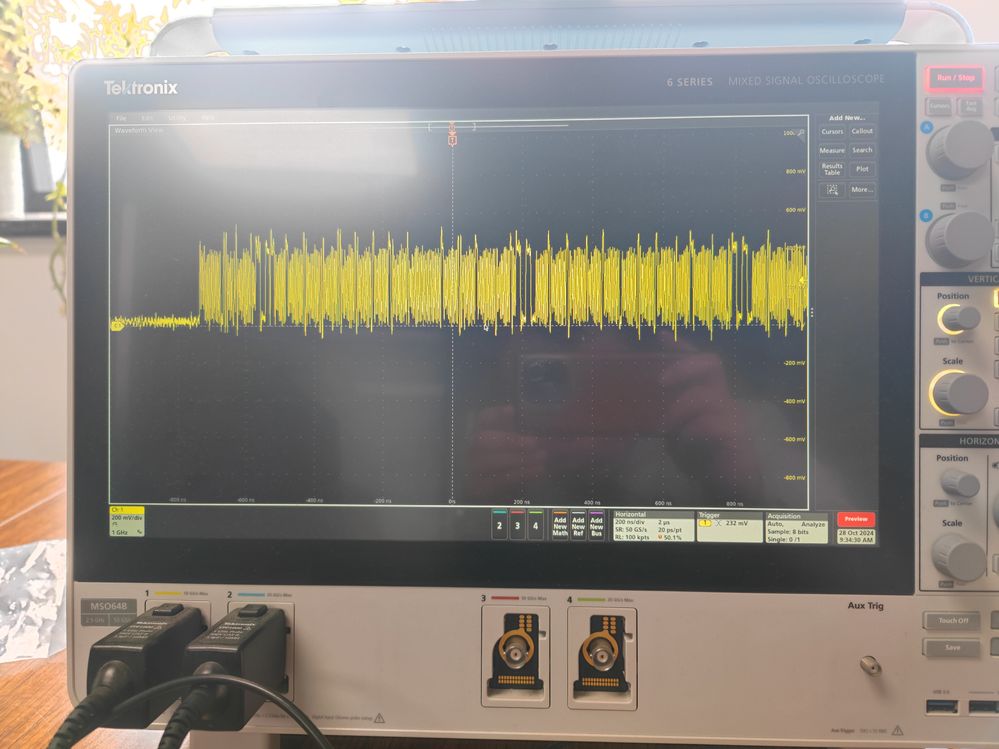

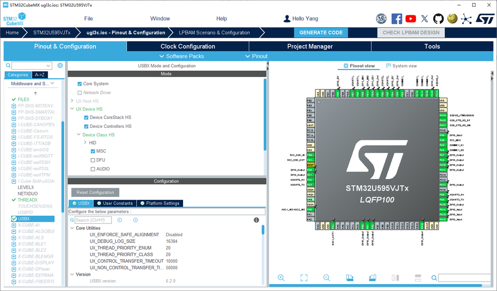

The divice is configured in High Speed Mode.  Yes, the logic stat of DEVLNSTS is not deterministic. Cube MX generate the code framework as the picture below. USBX and ThreadX are used in the software.
For the USB traffic, because the probe of the oscilloscape Tektronix MSO64 is 1GHz bandwidth, there might be some distortions about the signal measured.  The USB D+ waveform showes below during transmission.

Hi @Yang Yang
DEVLNSTS represent logic level of DP and DM to make sure that there is a stable resume state whenever suspended. High speed levels are 0 and 400 mV. In suspend/resume the bus always goes back to full speed mode if it was in High-speed mode. So, at connection, during suspend and also leaving suspend.
This register field is reading "logic level" which is the 3V logic level. It could be checked whenever to be sure that there is a stable resume state and not just noise that generated a system event.
