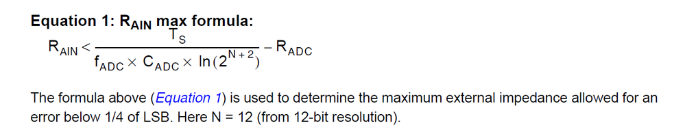

You're correct, only the maximum external input impedance (R_AIN) is shown. However you may estimate the sampling switch resistance (R_ADC) using R_AIN and internal S/H capacitance (C_ADC) using the following expression:
0693W00000FCq95QAD.pngOne thing to note is that R_AIN for the STM32H745xI/G is determined using the following tolerances: "The tolerance is 10 LSBs for 16-bit resolution, 4 LSBs for 14-bit resolution, and 2 LSBs for 12-bit, 10-bit and 8-bit resolutions."
