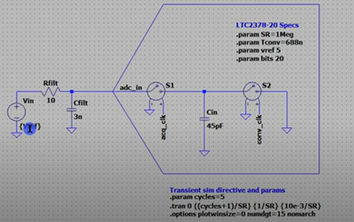

We are using STM32G0x0 family in our project. We are running ADC clock at 30MHz. The sampling time is 7.5 cycles, we configure the ADC to trigger every 500uS so Trigger Frequency = 2kHz and the resolution is 10bits. I know the Tconv = Tsampling + 12.5 = 20cycles = 666.7 nS. How do I calculate Tacq?

‎2024-08-14 7:45 AM - edited ‎2024-08-14 8:04 AM
Tacq = Acquisition time. It is the time required for the Analog-to-Digital Converter (ADC) to capture the input voltage during sampling.
I am simulating this circuit basically, where it models the ADC. In the image Cin = 45pF, but in my case Cin = 5pF. Tconv = Conversion time = Tsamp + 12.5cycles. Additionally
Sampling Rate = Tacq + Tconv. In the example, they choose Sampling rate = 1MSPS, Tconv = 688ns and Tacq = 312nS.
The example is using an ADC from LTspice but in my case, I am using a STM32G0x0 MCU. So if I am sampling every 500uS, then my sampling rate is 2KSPS no? Is this possible? Because the DS shows the Maximum Tsampling is 4.56uS at fADC = 35 MHz. I am a hardware engineer, not a firmware engineer.
Additionally, I found that the RC filter must comply with this: https://community.st.com/t5/stm32-mcus-products/is-there-any-required-external-circuitry-for-the-adc/td-p/189255. That's why I am interested to find my Tacq.
‎2024-08-14 8:09 AM
Tacq = Tsampling / fADC
In this case, Tacq = 7.5 / 30 MHz = 250 ns.

Dear @gomezramones ,
This App Note may help you on the hardware design , especially in case of High impedance source in Section
4.4 High impedance source measurement
How to optimize the ADC accuracy in the STM32 MCUs - Application note
However I see you your External RC may be problematic with Charge transfer RC between you signal , External Cext of 3nF , Rext = 10Ohm versus our Internal requirements for good accuracy to reach such as 1/2 LSB in 10-bits.
