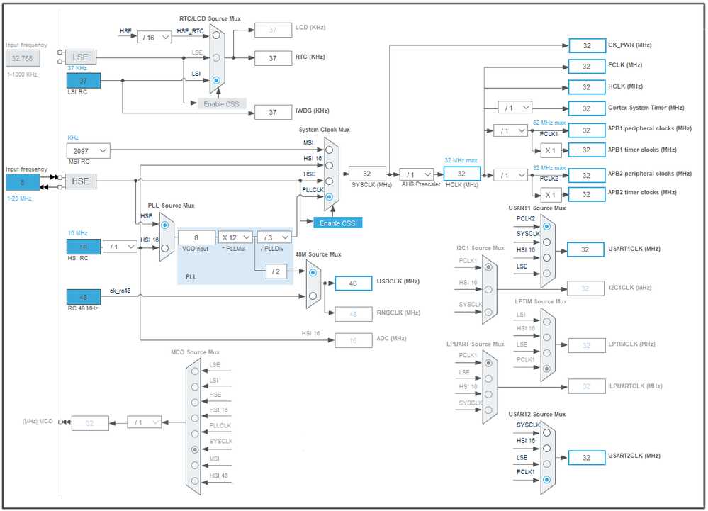

I have my own board, with STM32L053C8T6TR. And I set clock and program failed here: while (LL_RCC_HSE_IsReady ()! = 1) {};
void SystemClock_Config(void) {
    LL_APB1_GRP1_EnableClock(LL_APB1_GRP1_PERIPH_PWR); // clock pro PWR controller
    LL_PWR_SetRegulVoltageScaling(LL_PWR_REGU_VOLTAGE_SCALE1); // 1.8V pro core
    while (LL_PWR_IsActiveFlag_VOS())
           ; // wait on supply change
    // PLLCLK = 8MHz * 12 / 2 = 32MHz
    LL_RCC_HSE_EnableBypass();
    LL_RCC_HSE_Enable();
    while(LL_RCC_HSE_IsReady() != 1){};
    LL_FLASH_SetLatency(LL_FLASH_LATENCY_1);
    LL_RCC_PLL_ConfigDomain_SYS(LL_RCC_PLLSOURCE_HSE, LL_RCC_PLL_MUL_12, LL_RCC_PLL_DIV_3);
    LL_RCC_PLL_Enable();
    while(LL_RCC_PLL_IsReady() != 1){};
    /* Sysclk activation on the main PLL */
    LL_RCC_SetAHBPrescaler(LL_RCC_SYSCLK_DIV_1);
    LL_RCC_SetSysClkSource(LL_RCC_SYS_CLKSOURCE_PLL);
    while(LL_RCC_GetSysClkSource() != LL_RCC_SYS_CLKSOURCE_STATUS_PLL){};
    /* Set APB1 & APB2 prescaler */
    LL_RCC_SetAPB1Prescaler(LL_RCC_APB1_DIV_1);
    LL_RCC_SetAPB2Prescaler(LL_RCC_APB2_DIV_1);
    SysTick_Config(32000000 / 1000);
    SystemCoreClock = 32000000;
    NVIC_SetPriorityGrouping(0x300);
    LL_Init1msTick(32000000);
    LL_SetSystemCoreClock(32000000);
    // Enable USB clock
    LL_RCC_SetUSBClockSource(LL_RCC_USB_CLKSOURCE_PLL);
    // Start timer TIM2
    CLOCK__StartMasterMSECtimer();
Does anyone see a problem here?
Do you have a clock signal coming in to HSE or are you using a crystal?
I use a crystal. This will probably be my problem. To be sure, I'll try to check it with an oscilloscope, but I have it at work.
So I'll try to rewrite my code and remove this line.
If you have a crystal, bypass mode is not what you want.
Yes. It is true. I have my own board, but I'm testing the application on NUCLEO-L053. And I forgot about this. Here is function clock settings for nucleo or my own board.
Thank you for your advice. :smiling_face_with_smiling_eyes:
