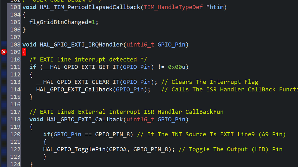

My code was compiling fine, then I turned on the Doxygen setting in preferences. Now i get lots of errors and warnings. My function prototypes say used but never defined. My functions say invalid storage class. I can't find what is broken. I turned off doxygen setting and removed alll the comments it added, no luck. Help?

Personally dislike opening bracket on a separate line, but standardized formatting in C is never going to happen since it hasn't already. But since HAL uses it, I'll use it if editing HAL files.
Two IDEs I use, CLion and STM32CubeIDE, both give warnings on mismatched brackets. TI CCS sort of gives a warning, but not really. STM32CubeIDE is particularly aggressive about it with a big red X.

Is there a particular setting to get this red cross on missing bracket? For me CubeIDE does not do this.
