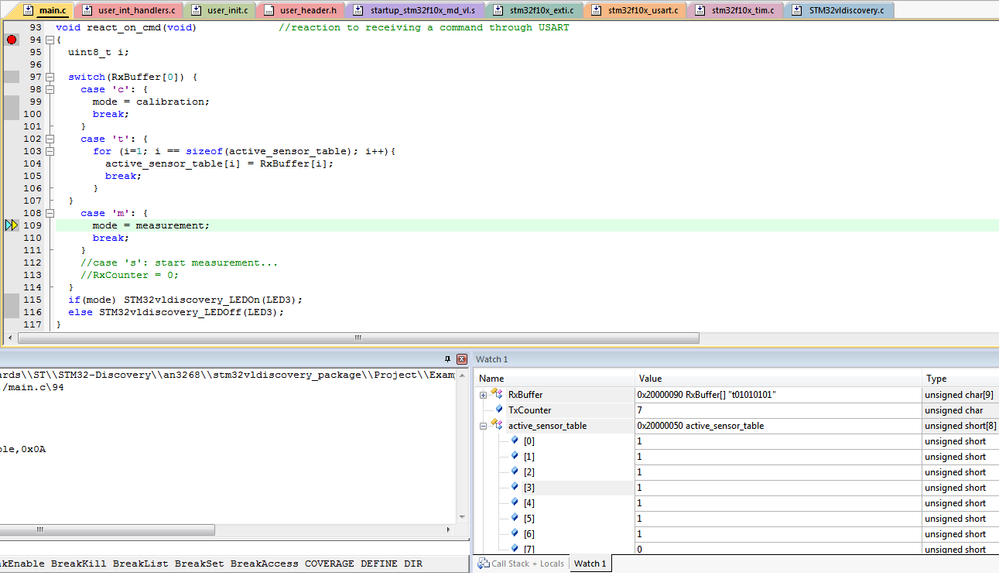

Hi
I just can't understand this... So, I'm communicating with PC's terminal program via USART2 on my STM32F10. Communication is running smoothly both ways, but I have a problem when I want my embedded system to respond appropriately to PC's commands. Basically, when ''I'' receive 9 characters, I read the first character and optionally what's behind, but mostly just 1st character matters. So, if I send for example 9 x m (RxBuffer = ''mmmmmmmmm'') or any combination of 'm' and ''whatever follows'', it seems to work fine, and the LED goes off. Similarly with 'c' (LED goes ON).  But, if I send i.e. ''t01100100'' or ''ttttttttt'', switch interprets it as 'm'. o_O Well, screenshot says it all.
Thanks for taking time :)

Posted on May 15, 2014 at 18:18
The break is on the for, not the case
You will need a break on the case to stop it falling through to the next one, which is default switch/case behaviour defined by the language.

Posted on May 15, 2014 at 18:25
Thanks for noticing, howerer it doesn't solve it. The behaviour is completely the same.
Posted on May 15, 2014 at 18:43
Post the code, I can't edit text in graphical format....

Posted on May 16, 2014 at 09:59
void react_on_cmd(void)       //reaction to receiving a command through USART
 uint8_t i;
 switch(RxBuffer[0]) {
  case 'c': {
   mode = calibration;
   break;
  case 't': {
   for (i = 1; i == sizeof(active_sensor_table); i++){
    active_sensor_table[i] = RxBuffer[i];
  break;
  case 'm': {
   mode = measurement;
   break;
  //case 's': start measurement...
  //RxCounter = 0;
  default: {
   strcpy(TxBuffer, ''\nCommunication error'');      //send RST indicator to PC
   TxCounter = 0;
   USART_ITConfig(USART2 , USART_IT_TXE , ENABLE);
 if(mode) STM32vldiscovery_LEDOn(LED3);
 else STM32vldiscovery_LEDOff(LED3);
Is this sufficient or you need other parts of program?

Posted on May 16, 2014 at 10:37
Hi !
One thing first, don't put braces around case statements, i.e.
switch(expression){
case 1:
break;
case 2:
break;
default:
break;
Second thing, in case't', the for loop will never execute, unless active_sensor_table has only one element. It should be defined as
(for i = 1; i < sizeof(active_sensor_table); i++){...}
Then if your table contains words, since sizeof(active_sensor_table) will give you the size in bytes, you'll have a runaway pointer for sure...

Posted on May 16, 2014 at 11:59
Wau, thanks, i think those brackets were the issue (gotta relearn the syntax i guess :))! I also repaired the sizeof() - countof = (sizeof (a)/sizeof(*a)).
Take care

frankmeyer9
Posted on May 16, 2014 at 12:31
Actually, the practice of putting case branches into brackets, is perfectly legal and often seen (albeit I strongly dislike it, too).
It usually makes no sense - except to create a new context for declaring local variables.

Posted on May 16, 2014 at 14:18
Ah, since I have never seen this before, I assumed it was not correct. As you (fm) said, it is only meaningful for handling very local variable (and of course I also (wrongly) assumed that each case had its own context).
