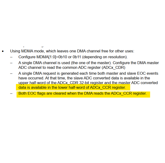

We can read the data from ADCx_CDR register in dual mode. The upper half word of ADCx_CDR consists of slave data and the lower half word of ADCx_CDR consists of master data. But in the manual mentioned ADCx_CCR for master data and EOC cleared when we read the ADCx_CCR.
The above bold one needs to be corrected I believe. Below is the snippet from manual0693W00000D0ei0QAB.png

Yes, I confirm this typo.
We will correct this typo in the next release.
