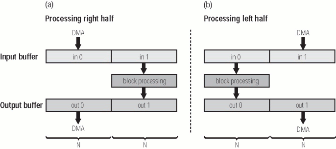

DB..1
First, I tried to invert the buffer data (in FWK_MEMPOOL_Read function) :
uint8_t *tmp_pData;
uint8_t i = 0;
*/ Backup pData */
memcpy(tmp_pData, pData, DataSze);
/* data inversion */
for (uint8_t bit = DataSze - 1; i <= 0; i --) /* decrement */
    pData[i] = tmp_pData[bit];
    i += 1;
*/ Copy the new buffer */
memcpy(pData, tmp_pData, DataSze);
But it doesn't work.
The sound stops after a few milliseconds.
You declare tmp_pData as a pointer, but you never point it TO anything. So your first memcpy() writes to random memory. Maybe RAM, maybe Flash, maybe non-existent memory space. If "DataSize" is a known, fixed size, then use "uint8_t tmp_data[DataSize]" as the declaration (note the change in the variable name since it is no longer a pointer). If DataSize in not known in advance, the issue becomes a bit more involved. The easiest (but maybe not the best) solution is to use malloc/free. But then you are allocating and freeing a buffer for every segment of audio data. May be OK, may not be OK. Could you simply have the DMA start at the end of the buffer and decrement its pointer instead of increment?
Hmmm... question: do you want to play each BUFFER of data backwards? Or do you want to play the entire audio stream backwards? Your code above plays each buffer full backwards. This is like saying "counting from 100 to 1 backwards" is "10 9 8 7 6 5 4 3 2 1" then "20 19 18 17 16 15 14 13 12 11", etc. Obviously not the same as "100 99 98 97 96 ....".
DB..1
Thank you @Bob S for your response.
I wanted to use tmp_pData to reverse the words and write it to the pData buffer.
But this was not the right solution.
What I would like is to read each data buffer backwards.
I'm making some clarifications. Namely, I use a circular DMA with a double buffer to read a sound.
The Wave file is stored on a USB stick and is loaded by a routine using the BSP_AUDIO_IN function.
The double buffer is BufferCtl.buff with a size AUDIO_OUT_BUFFER_SIZE
The buffer is only half used with each BSP_AUDIO_OUT_TransferComplete_CallBack and BSP_AUDIO_OUT_HalfTransfer_CallBack call.
               BufferCtl.buff
[0 ---- > AUDIO_OUT_BUFFER_SIZE/2]
                                   BufferCtl.buff
[AUDIO_OUT_BUFFER_SIZE/2 ---- > AUDIO_OUT_BUFFER_SIZE]
DB..1
