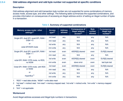

I have some strange results when reading the configuration registers on the APS6408L-3OBMx.

APS6408_ReadReg(hospi, 0, Reg0_1, 5);
APS6408_ReadReg(hospi, 1, Reg1_2, 5);
APS6408_ReadReg(hospi, 2, Reg2_3, 5);
APS6408_ReadReg(hospi, 3, Reg3_4, 5);
APS6408_ReadReg(hospi, 4, Reg4_8, 5);
APS6408_ReadReg(hospi, 8, Reg8_0, 5);
Result:
Reg0_1: 0x09 0x0D --> OK
Reg1_2: 0x09 0x0D --> same value as with address 0x00!
Reg2_3 0x93 0xE0 --> OK
Reg3_4 0x93 0xE0 --> same value as with address 0x02!
Reg4_8 0x50 0x05 --> OK
Reg8_0 0x05 0x09 -->OK
To me this seems like the odd addresses are not read as expeceted, the result is indipendent of the last Bit of Address!

Hello @MHoll.2
The behavior you’re seeing—where reads from odd addresses return the same data as the previous even address—is a known limitation of the OCTOSPI interface. As detailed in the errata sheet (ES0491, section 2.8.4), odd address alignment and odd byte counts are not supported under specific conditions.
