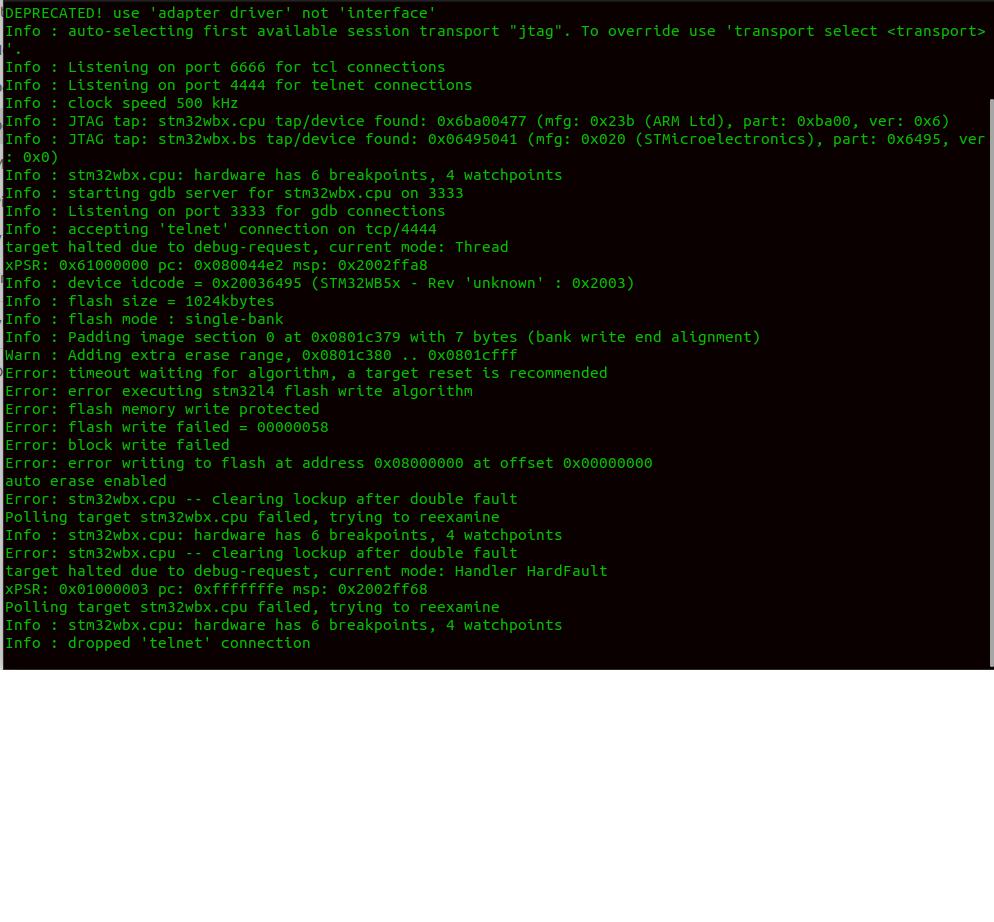

I am trying to flash code using openocd(through JTAG) in option byte RDP protection level is set to AA(0) but still openocd throwing error memory is write protected can not write on address 0x8000000.

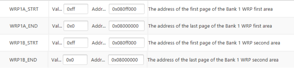

The FLASH pages can also be protected against unwanted write (WRP) due to loss of program counter context.
The user area in flash memory can be protected against unwanted write operations. Two write-protected (WRP) areas can be defined, with page (4 Kbytes) granularity. Each area is defined by a start page offset and an end page offset related to the physical flash memory base address. These offsets are defined in the WRP address registers Flash memory WRP area A address register (FLASH_WRP1AR) and Flash memory WRP area B address register (FLASH_WRP1BR).
  • Can you check those registers ?

I have uploaded photos of WRP1A and WRP1B start and end address values please let me know what's wrong with this value i have tried WRP1A_STRT = WRP1A_END and WRP1B_SART = WRP1B_END but still facing the same issues.

  • Your values seem correct. If you can verify WRP, that means you are attached to the target. Can you please enter in the first tab named "Memory & File editing" and then try to write manually a random value at the first flash address 0x08000000. Is it working ?

  • 2nd error on your screenshot : " Error executing stm32l4 flash write algorithm ".  This is surely not the issue but are you sure your flashing the right algorithm ?
  • Last thing, are you using sysfsgpio ? Also the first line advise you to use 'adapter driver', can you switch ?

  • In "Memory & File editing" i am able to to write manually a random value at the first flash address 0x08000000.

We can conclude there are no mechanism protecting STM32 flash, so the problem must come from somewhere else :
  • When you create your target, how did you configure your work area ? Setting WORKAREASIZE especially...
  • The first error is "timeout waiting for algorithm, a target reset is recommended", you should check your algorithm. Maybe because you're halting the CPU ?
  • Have you modified the Run configurations (or did you keep by default) ? Can you try other reset mode ?
