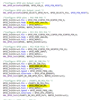

1. Does GPIO Mode AF_PP or AF_OD have negative effects on power consumption vs mode ANALOG? Keep in mind that the Pull on all of these is set to NOPULL. (See photo for reference).

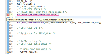

2. Adding the line below gives a fatal error stating there is "too few arguments to function". Any suggestions?
/* FLASH Deep Power Down Mode enabled */
HAL_PWREx_EnableFlashPowerDown();

Push-pull output is generally used for unidirectional line communication; open-drain output is usually used for bidirectional line communication. Due to the presence of pull-up resistors, open-drain output has relatively higher power consumption.
The AN4899 (STM32 GPIO configuration for hardware settings and low-power consumption) provides a detailed description of the various GPIO modes and you will find some guidelines for power optimization.
The arguments of this function HAL_PWREx_EnableFlashPowerDown() can be PWR_FLASHPD_LPRUN or PWR_FLASHPD_LPSLEEP.
It allows to enable flash power down capabilities in low power run and low power sleep modes.
The UM2442 describes the STM32WB HAL and low-layer drivers.

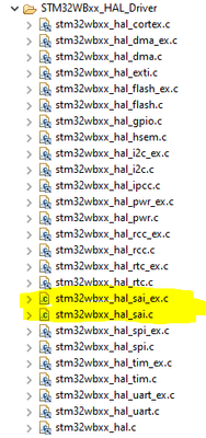

2. Another find I have is that whenver I alter the BLE_Sensor.ioc whether it's setting all the free pins as analog or reconfiguring GPIO's, some files (highlighted but sometimes others) getting deleted. Why does that happen? Luckily I have a backup copy of this firmware and can drag and drop the missing .c, but seems strange.

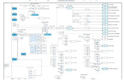

3. Do you think there is any utility to lowering the power consumption by altering (lowering) the clock frequency. Our application requires sampling no more than 1 Hz at the moment. I included a screenshot of the clock config.
I am learning power consumption optimization is a tricky endeavor. Any help would be greatly appreciated. THANKS!

Hi again - Following up on my latest post.
Any insights into changing the clock frequency to lower the power consumption as much as possible?
