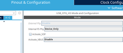

I've done the first pic, set Vbus internal fs phy. I don't know where you got the second pic from?

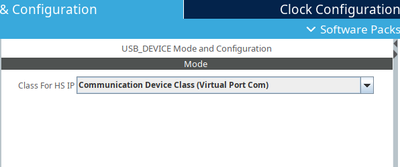

here...
Thats : decision ->  host or device
>second pic
...then set, what it should be/do : serial CDC , keyboard HID , storage ...etc.
Otherwise it cannot "guess" , what you expect.

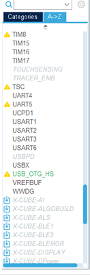

Hello
I have attached my clock ioc file and I can't find the USB_DEVICE option like the one you presented on your screenshot. Maybe I'm doing something wrong?

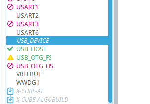

How did yiu ge the USB_Device part?
As always... :)
in IDE -> Cube -> pinout A-Z
you see host or device - what you set to be active - then choose, what it should do:
here OTG -->host  , then host --> MSC or other:
do same for device , what you want. (but device AND host same time dont work, so only one at a time is possible.)
