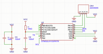

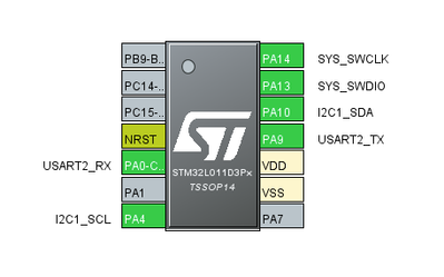

I made pcb with stm32l011d3, but st-link doesn't detect mcu.
Detect other commercial pcb with st-link, so st-link has no problem.
I know that boot0 in the current dataset is not connected to gnd. It is not recognized even if I connect it to gnd right away.
What am I not doing well?

Some possibilities:
  • The chip needs power. Measure it with a voltmeter. It should be reported correctly in STM32CubeProgrammer. Programmers generally do not provide power.
  • SWDIO/SWCLK/GND need connected, correctly.
  • If you have a knock-off programmer, it may not work with your chip or ST tools.
I checked swdio and swclk when mcu was not recognized, there was no problem.
I plugged in the power when I connected the st-link. I confirmed that the capacitor is 3.3V.
Based on the mcu on the other PCB also recognized as the same st-link, st-link does not seem to be knock-off.

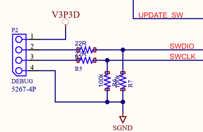

Do I need 22 resistance and 100k pull down for swd unconditionally?
I'm asking because I'm connected to a swd like this from another pcb I didn't make.
There's a saying in the search results that it's okay not to have it, and other articles use it in a pull-up form
<The swd circuit of the PCB I have>
<Searched Swd Circuit>
