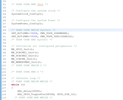

I used PA11 and PA12 as standard GPIO in STM32U595ZJT6Q and system frequency is 4MHz. Config PA11 and PA12 to PP output mode ,no pull up.Don't set this gpios to high, the mini system current is 3mA,but set this gpios to high, the current is 22mA.
Test PA10 or PA0,this current no changed.
I reference RM0456 rev4  13.3.16  and 10.7.12 ,used PA11 and PA12 as standard GPIOS,the USBPWREN and VDD11USBDIS bits in PWR_VOSR must be set.
I config these bit before config GPIO, but this current no changed,still is 22mA.

Did you tried to set FORCE_USBPWR bit in PWR_CR1? Does it have any impact?
Are you using your own board or an ST board?

I will tried to set FORCE_USBPWR bit in PWR_CR1 tomorrow.
I have U599 EV board.
I tried U599 EV board too, but its current  also is 22mA . Too bigger.Using other gpio , it's right, only PA11 and PA12.

I set FORCE_USBPWR bit in PWR_CR1,the current  smaller from 22mA to 15mA.But its to bigger.
