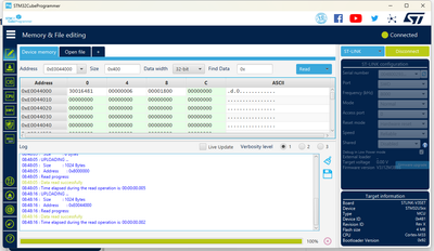

Could you please tell me the REV_ID of the devices you used for test (0xE004 4000)?
-Amel
This picture is the MCU message read by STM32CubeProgram.
Sunwaz
The value is 0X30016481 @0xE004 4000.
