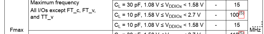

I do NOT want to test the OCTASPI (QSPI) in STM32 chip (I trust it will work as a QSPI master). An external QSPI memory is NOT my target (no benefit if I would solder a QSPI memory chip to test against it).
The intension is: to test an external slave device with a QSPI interface. It is a chip under development (I cannot disclose which one and for what), so I need a QSPI master talking to this "new" chip (or an FPGA emulating this chip before we will tape-out).
I need this STM MCU as a QSPI  test vehicle to verify an external chip (which is NOT a memory chip): QSPI is used instead of regular SPI in order to access, program and configure... a new chip in development and for verification/characterization I need QSPI. BTW: QSPI can be used on any chip/board, even it is not a memory chip.
All fine: I know the issue with flying wires (and ribbon cables, impedance matching, signal termination ...). I would need anyway a "long cable", because: for testing - this new chip will sit in an oven (for temperature tests/characterization). So, I need a QSPI as master, talking to a QSPI slave device (chip) with the options to tweak the QSPI timing (esp. "round trip delay").
Luckily, the STM32 MCU provides several great features, such as DLYB block, additional half-clock-cycle delay of CLK for reading QSPI response, 1V8 MCU operation (actually, I would need also 1V2, but 1V8 as QSPI level is ok for now).

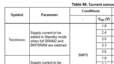

Just -- how did you set the thresholds ?
+ btw 1,8V is the lowest value i see in the ds tables (for standby/stop modes)
and for wakeup 3,0V :
