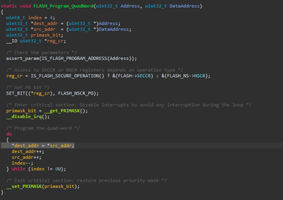

But when I call the HAL_FLASH_Program, I am getting a hardfault at this point, because I am trying to write to write to the address calculated above:

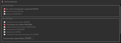

What is the nature of the hard fault? There's a hard fault analyzer window (Window -> Show View -> Fault Analyzer) which can shed more light.
G_Anastasopoulos
From the Fault Analyzer I am getting this:
Does this mean that I am not supposed to write directly to that address?

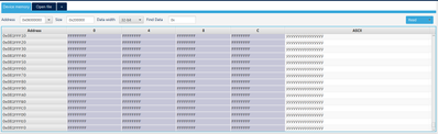

If I attempt to read the first 2MB only, like this:
I see indeed FFFFs everywhere.

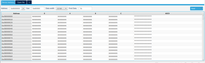

When I try to read all 4MB, like this:
I see AAAAs, which I am not sure what this means. I am not getting any warning that I am attempting to read past the size of the flash or anything like that.

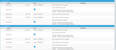

The option bytes as read from the Programmer look like this:
In the user configuration OB I see this option:
Not sure what does it mean for my case though. I tried to unset it and run the code with the same results
