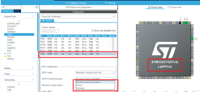

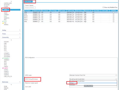

Meanwhile to answer your remark regarding how to configure pull-up/down resistors in CubeMx on already configured pins for peripherals, you need to go to GPIO -> SDMMC and select what GPIO you need to set the internal resistor as indicated in the following screenshot:

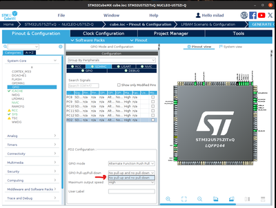

regarding the screen shot that you shared, is it STM32U5 series? because I can't select pull-up there (my screen shot is for CMD line but that's the same for other SDIO pins as well):

miladmohtashamirad
Hi.
No. I'm using 6.11.1-RC2.
Ok. if it's showing up in later versions of CubeMx, it proves that probably there's no hardware limit for turning pull resistors.
Thank you.
