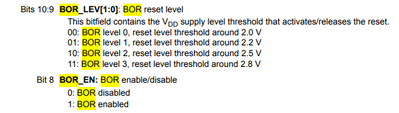

In version 4 of the reference manual for STM32U0, it is suggested that BOR is enabled and on Level 3 from the factory.
Is that correct?

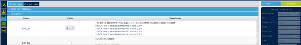

I'm currently working on an construction running @ 2V, so it would never start up, if so. And when I read out the Option Bytes on a new MCU, BOR is disabled?
https://www.st.com/resource/en/reference_manual/rm0503-stm32u0-series-advanced-armbased-32bit-mcus-stmicroelectronics.pdf

Also, you can use STM32CubeProgrammer to verify and make sure of the current BOR value.

However, I think my question was misunderstood.
My construction works fine and is is running fine @2V. But I never programmed the Option Bytes.
That is why I suspect that there is an error in the reference manual, as it looks like the BOR is disabled from the factory, which is the opposite of what is written in the manual.
